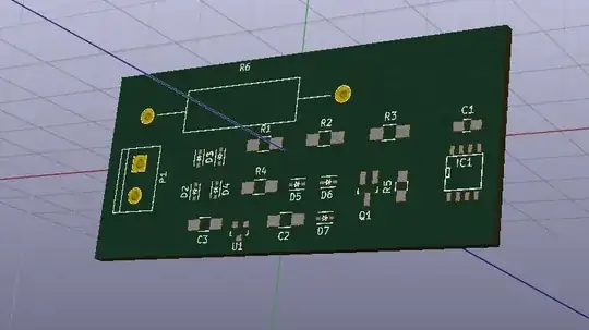

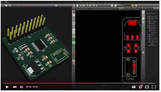

I'm just starting to work with KiCAD. One of the video tutorial shows that 3D view should incorporate components placed on the board:
However in my case I can see only the board with pads:
Looks like I need to tune up my KiCAD installation (I'm using Windows 7, KiCAD version 4.0.0).
Could anyone give me any advize for that?

  • You will need to create 3D models, or find pre-made ones (perhaps from 3DContentCentral.com) and attach them to the footprints you're using. I haven't used KiCAD much (never cared much for it) but that's how it works in Eagle and Altium. – DerStrom8 Sep 23 '15 at 14:44
  • Few of the components have 3D models so far, however the SMD capacitors should be present. – Simon Richter Sep 23 '15 at 15:58
  • Common problem is missing path to 3D directory corresponding to relative path assigned to module. Double check also module property if 3D is really defined there. As last chance try a low level tool (SysInternals, strace or so) to see what WRL is being read. – TMa Sep 28 '15 at 18:30
  • Also be sure that you have "Show 3D Models" enabled in Preferences menu of 3D Viewer. – Michal Oct 23 '15 at 17:03

For Fedora 29 I had to install a separate package: $ sudo dnf install kicad-packages3d
perja
  • 281
  • on Arch, kicad-library-3d from AUR since kicad-packages conflicts with kicadr-library – Rohith Balaji Sep 26 '20 at 09:15
    same on Ubuntu 20.04, i had to install `kicad-packages3d` with `apt`. – Carton_ Sep 27 '21 at 06:36
  • Also necessary step on Fedora 35, as of Feb '22. Despite warnings of lock files and such on opening KiCad, 3-D models will then work without any other tweaks. – Hektor Feb 06 '22 at 09:57

I solved this issue doing this:
  • Run Eeschema
  • Open CvPcb to associate components and footprints
  • Open Preferences -> Configure Paths
  • On "KISYS3DMOD" change the path to the correct one. "C:\Program Files\KiCad\share\kicad\modules\packages3d" in my case.
  • Restart the program.
  • Enjoy!
jularaXD
  • 184
If you're on a Mac, the KISYS3DMOD path variable needs to be changed to: /Library/Application Support/kicad/packages3d. As installed, it had modules/ in between kicad/ and packages3d, but the modules directory doesn't exist in the OS X installation, at least on my version, 2015-10-10 BZR 6258.
Note that only footprints having 3D models will appear, as mentioned in another answer.

On Ubuntu 14.04 the correct path is:
/usr/share/kicad/modules/packages3d

This problem seems to be resolved for more recent versions of KiCad. I did however run into the same symptoms but different cause with KiCad 5, which I'm posting here for any wanderers who find this thread looking for the solution.
Basically if you have run KiCad 4 on your computer and then installed KiCad 5, the libraries are messed up. A full solution is discussed here. It boils down to going to
KiCad -> Preferences -> Manage Footprint Libraries
Then deleting all of the KiCad default libraries (which should be GitHub for ver 4) and re adding them from ${KISYSMOD} which varies by OS, but for macOS was
/Library/Application Support/kicad/modules/

In Ubuntu 20.04 LTS this is what worked for me:
  1. Path /usr/share/kicad/modules/packages3d
  2. Download Package sudo apt install kicad-packages3d
  3. Restart kiCAD
In the 3D view window, ensure that"Show 3D footprints" is enabled. You will also need to make sure that the components you are using have 3D models available. Most of the standard packages that come in the library have 3D models. If you created your own footprints or components, these won't have 3D models.

I had similar problem on Debian 10 buster (stable). The packages3d folder is not included by default, all I did was to download it from here. Extract and place the content of the download in the directory /usr/share/kicad/modules/packages3d

On Linux, the kicad-packages3d may also be installed to /usr/share/kicad/3dmodels/.
To set the correct path, open KiCad, select Preferences->Configure Paths, and set the path /usr/share/kicad/3dmodels/ for KISYS3DMOD. Restart KiCad and try again if the 3D components now work.
For me this was the case on Ubuntu 18 and KiCad 5.1.7 (installed with the sudo apt install --install-recommends kicad command).
To check if kicad-packages3d is installed in the first place, run: dpkg -s kicad-packages3d (Debian/Ubuntu)
For Debian, you need to install the kicad-packages3d package as it is not installed by default when you install the kicad package. I think this is reasonable because kicad-packages3d is a 300M+ download and after installation, /usr/share/kicad/modules/packages3d/ is 5.1G.
