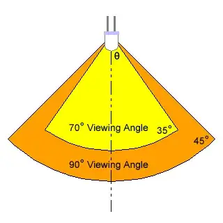

  • LED Specs:
    Different LEDs have different viewing angles. You can select a narrower angle to keep the light where you want it:
viewingangle

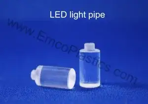

  • Light pipes:
    A light pipe is a piece of clear plastic the acts as a waveguide for visible light. You attach/glue the light pipe into your top panel, with the bottom edge of the pipe directly over your LED. Most of the light is then guided up to the surface of your panel.
    In this picture, the smaller end is the part that goes through your top panel, and the wider end hovers over your LED:
    pipe
