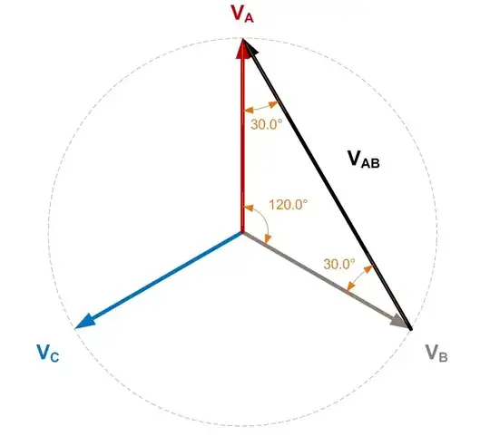

Let's call the 3 phases A, B and C and let's say we notionally have a neutral wire. Neutral is basically 0V in the system.
The "A" phase voltage (to neutral) is my chosen reference that all other voltage phase angles are measured from hence, V\$_B\$ is 120 lagging V\$_A\$ and V\$_C\$ is 120 degrees leading V\$_A\$.
OK so far?
What about the voltage between line A and line B (aka V\$_{AB}\$) - this is called line voltage (not to be mistaken with voltages between phase and neutral). Line voltages are \$\sqrt3\$ times bigger than phase voltages.
OK so far?
If you are not just examine what happens here: -
If you use trigonometry and resolve all the triangles you can find the length of V\$_{AB}\$ - it is \$\sqrt3\$ times bigger than either A or B to neutral.
It's also 30 degrees leading A and this is where the 30 degrees comes from.
So, a delta primary will receive primary line voltages of V\$_{AB}\$. V\$_{BC}\$ and V\$_{CA}\$.
Given that a transformer doesn't inherently phase shift anything (other than the trivial cases of 0 degrees and 180 degrees), any secondary winding voltage must be in phase with their respective primary voltage no-matter whether the secondary is connected delta or wye.
OK so far?
Then you have it because, a delta primary works with line voltages and these are 30 degrees shifted to their nearest phase voltage. The secondary outputs are also 30 degrees shifted and hence a wye secondary will produce a phase voltage that is 30 degrees shifted from the equivalent (but not directly connected to) phase voltage on the primary.
It's trivial to do the wye-delta transformer so I'll leave it to someone else.

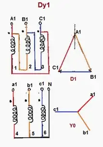

There're two types of problems related to vector groups: 1) given the connection diagram of the Tx and the phase sequence of the system, get the vector group; 2) given the vector group and the phase sequence of the system, get the connection diagram. The first type is easier, it's just circuit analysis. The second type is a bit harder, you do trial-and-error until you get the correct connection diagram using another diagram, which name in English I don't know but translated from Spanish would be watch diagram (from diagrama de reloj). The phase shift \$ \delta \$ will always be a multiple of 30, and the values for the hour index will be 1, 2, 3, ... 11. Notice those numbers appear in an ordinary watch, thus the names "hour index" and "watch diagram". In practice you don't deduce the phase shift each time, rather we use tables which you can find in the previous webpage or in Google Images.
Alright. So you mentioned a transformer that shifts the line-to-line voltages from one side to the other by 30°. What's the connection diagram of such transformer? It depends: does \$ \tilde V_{{\text{LL}}_\text{s}} \$ lag, or lead, \$ \tilde V_{{\text{LL}}_\text{p}} \$? (This has nothing to do with power factor!) I will assume you meant the former. Therefore, by definition of \$ \delta \$ (read it above), we have \$ \delta = 30° \$ (make sure you understand why before proceeding). Thus, \$ \text{index} = \dfrac{\delta}{30°} = \text{index} = \dfrac{30°}{30°} = 1 \$. And since the transformer is delta-wye, finally we have that its vector group is Dy1 (assuming the secondary's neutral is floating, but if it's grounded it won't affect the phase shift in balanced conditions).
Now we know the vector group of the transformer in your question, but what's its connection diagram? This is the type II of problems I mentioned above; it is quite hard explain it if it's the first time you learn about vectors groups, so I'll "cheat" and use the tables. From the webpage of Electrical-Engineering-Portal, the connection diagram for a Dy1 transformer is the following, assuming positive phase sequence:

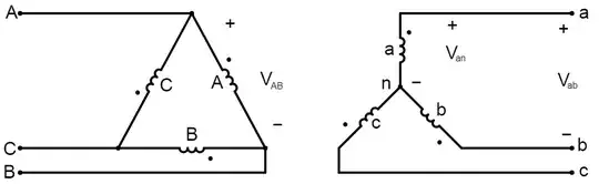

Connection diagram of Dy1 two-winding three-phase transformer
How do we know the previous connection actually yields a 30° lag of \$ \tilde V_{{\text{LL}}_\text{s}} \$ with respect to \$ \tilde V_{{\text{LL}}_\text{p}} \$? We can prove it (now this is a type I problem). Based on the image above, we draw a circuit diagram. On the high voltage (HV) side, notice the dotted terminal of the A winding (red) is connected to the phase A, the dotted terminal of the B winding (yellow) is connected to the phase B, and the dotted terminal of the C winding (blue) is connected to the phase C; on the same side, notice the dotted terminal of winding A is connected to the non-dotted terminal of winding B, the dotted terminal of winding B is connected to the non-dotted terminal of winding C, and the dotted terminal of winding C is connected to the non-dotted terminal of winding A, closing the mesh/delta. On the low-voltage (LV) side, notice dotted terminal of each winding a, b, c is connected respectively to the phase a, b, c; the neutral is at the non-dotted terminals of each winding. Taking all of this into account, we can construct the following circuit diagram, which I created using Falstad; please check the circuit diagram is consistent with the connection diagram.
Circuit diagram of Dy1 two-winding three-phase transformer
Our goal is to determine \$ \delta \$, in order to prove the given connection diagram is correct. And to get \$ \delta \$, we must determine the relation between the angle of \$ \tilde V_{{\text{LL}}_\text{s}} \$ and the angle of \$ \tilde V_{{\text{LL}}_\text{p}} \$. Assuming balanced conditions, we actually need to analyze only one phase, which will be A/a. To do this, we start with the line-line voltage on the HV side (left), treating it as a given quantity, and work our way to the line-line voltage on the LV side (right). Thus, we indicate the voltage phasors \$ \tilde V_{{\text{AB}}} \$ and \$ \tilde V_{{\text{ab}}} \$. A voltage on the winding A will induce a voltage on the winding a, but notice the secondary winding is in Y, so in order to get the corresponding line-to-line voltage on the secondary we must also indicate the phase voltage on the secondary, \$ \tilde V_{{\text{an}}} \$. And also notice the voltage \$ \tilde V_{{\text{AB}}} \$ really is not the voltage on the winding A; actually it's \$ \tilde V_{{\text{CA}}} \$, so we also must indicate this voltage. The result is the following circuit diagram with the relevant phasors indicated.
Circuit diagram of Dy1 two-winding three-phase transformer with relevant phasors indicated
We can start to analyze the circuit. I'll separate in steps so it's easier to follow.
  1. We need to relate the line-to-line voltage phasors on the HV side, \$ \tilde V_{{\text{CA}}} \$ to \$ \tilde V_{{\text{AB}}} \$. Since we assume balanced system and positive sequence, we have that
\$ \begin{align} \tilde V_{{\text{CA}}} &= \tilde V_{{\text{AB}}} \cdot 1 \angle 120° \tag*{} \\ &= | \tilde V_{{\text{AB}}} | \angle \theta_{\tilde V_{{\text{AB}}}} \cdot 1 \angle 120° \\ &= | \tilde V_{{\text{AB}}} | \angle (\theta_{\tilde V_{{\text{AB}}}} + 120°) \end{align} \$
  1. We need to refer the previous voltage to the LV side. Notice the reference polarity of \$ \tilde V_{{\text{CA}}} \$ and \$ \tilde V_{{\text{an}}} \$ are not both positive or both negative on the dotted terminals, so we use the \$-\$ sign in the transforming equation of voltages:
\$ a = \dfrac{N_\text{p}}{N_\text{s}} = - \dfrac{\tilde V_{{\text{CA}}}}{\tilde V_{{\text{an}}}} = \dfrac{\tilde V_{{\text{CA}}}}{\tilde V_{{\text{an}}}} \cdot 1 \angle 180° \tag*{} \$
Since we want to get the voltage of the LV side, we solve for \$ \tilde V_{{\text{an}}} \$:
\$ \tilde V_{{\text{an}}} = \dfrac{\tilde V_{{\text{CA}}}}{a} \cdot 1 \angle 180° \tag*{} \$
Substituting:
\$ \begin{align} \tilde V_{{\text{an}}} &= \dfrac{| \tilde V_{{\text{AB}}} | \angle (\theta_{\tilde V_{{\text{AB}}}} + 120°)}{a} \cdot 1 \angle 180° \tag*{} \\ &= \dfrac{| \tilde V_{{\text{AB}}} |}{a} \angle (\theta_{\tilde V_{{\text{AB}}}} + 120° + 180°) \\ &= \dfrac{| \tilde V_{{\text{AB}}} |}{a} \angle (\theta_{\tilde V_{{\text{AB}}}} + 300°) \\ &= \dfrac{| \tilde V_{{\text{AB}}} |}{a} \angle (\theta_{\tilde V_{{\text{AB}}}} - 60°) \end{align} \$
  1. We need to get the line-to-line voltage of LV side from the phase voltage of LV side. Since the LV side is in Y and the phase sequence is positive, we have that
\$ \tilde V_{\text{ab}} = \tilde V_\text{an} \cdot \sqrt{3} \angle +30° \tag*{} \$
Substituting:
\$ \begin{align} \tilde V_{\text{ab}} &= \dfrac{| \tilde V_{{\text{AB}}} |}{a} \angle (\theta_{\tilde V_{{\text{AB}}}} - 60°) \cdot \sqrt{3} \angle +30° \tag*{} \\ &= \dfrac{\sqrt{3} | \tilde V_{{\text{AB}}} |}{a} \angle (\theta_{\tilde V_{{\text{AB}}}} - 60° + 30°) \\ &= \dfrac{\sqrt{3} | \tilde V_{{\text{AB}}} |}{a} \angle (\theta_{\tilde V_{{\text{AB}}}} - 30°) \end{align} \$
  1. Notice we already have a relation between the line-to-line phasor voltage on the HV side, \$ \tilde V_{{\text{AB}}} \$, and the line-to-line phasor voltage on the LV side, \$ \tilde V_{\text{ab}} \$. The quantity \$\delta\$ is an angle, so we're only interested on the angles of the two previous phasors. Thus, ignoring the magnitudes and keeping the angles, from the previous equation we have:
\$ \theta_{\tilde V_{\text{ab}}} = \theta_{\tilde V_{{\text{AB}}}} - 30° \tag*{} \$
  1. By definition, \$\delta\$ is the angle by which \$ \theta_{\tilde V_{\text{ab}}} \$ lags \$ \theta_{\tilde V_{{\text{AB}}}} \$. Therefore, we can get \$\delta\$ immediately from the previous equation! It is
\$ \delta = 30° \tag*{} \$
  1. Applying the definition of hour index:
\$ \text{index} = \dfrac{\delta}{30°} = \dfrac{30°}{30°} = 1 \tag*{} \$
  1. Lastly, since the primary is in delta and the secondary is in wye, the vector group is Dy1. If the secondary's neutral was grounded, the vector group would then be Dyn1. This is the vector group that the EEP webpage said, so indeed the given connection diagram is correct.

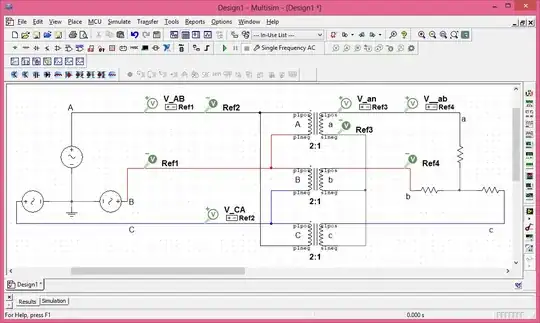

To further demonstrate the given connection diagram is correct, I ran a simulation on NI Multisim using \$ \tilde V_{{\text{AB}}} = 50 \sqrt{3} \angle 0° \text{ V} \$ and \$ a=2 \$ (you can ignore the ground, the balanced load, and the operating frequency):
Simulation setup for Dy1

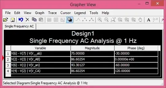

Simulation results for Dy1
from which
\$ \begin{align} \delta &= \theta_{\tilde V_{{\text{AB}}}} - \theta_{\tilde V_{\text{ab}}} \tag*{} \\ &= 0° - (-30°) = 30° \end{align} \$
the same as before.

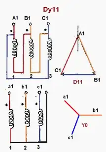

Edit: Dy11 transformers
Above I assumed you meant that \$ \tilde V_{{\text{LL}}_\text{s}} \$ lags \$ \tilde V_{{\text{LL}}_\text{p}} \$ by 30° (which is equivalent to saying \$ \tilde V_{{\text{LL}}_\text{p}} \$ leads \$ \tilde V_{{\text{LL}}_\text{s}} \$ by 330°), in other words a Dy1 transformer. In case you meant that \$ \tilde V_{{\text{LL}}_\text{s}} \$ leads \$ \tilde V_{{\text{LL}}_\text{p}} \$ by 30° (which is equivalent to saying \$ \tilde V_{{\text{LL}}_\text{p}} \$ lags \$ \tilde V_{{\text{LL}}_\text{s}} \$ by 330°), then the vector group would be Dy11. The connection diagram, from the same webpage of EEP, would be the following.
Connection diagram of Dy11 two-winding three-phase transformer
The circuit diagram would be:
Circuit diagram of Dy11 two-winding three-phase transformer with relevant phasors indicated
Let's quickly prove the diagram above is correct; it's similar to the previous case. Notice we still connect the dotted terminals of the HV side to the lines, and we still connect the non-dotted terminals of the LV side to get the neutral. What has changed is the winding inter-connections of the HV side. Before, we connected the dotted terminal of winding A to the non-dotted terminal of winding B, but now we connect the dotted terminal of winding A to the non-dotted terminal of winding C.
  1. In this case, \$ \tilde V_{{\text{AB}}} \$ is indeed the voltage applied to the winding A.
  2. The reference polarity of \$ \tilde V_{{\text{AB}}} \$ and \$ \tilde V_{{\text{an}}} \$ are both positive on the dotted terminals, so we use the \$+\$ sign in the transforming equation of voltages:
\$ a = \dfrac{N_\text{p}}{N_\text{s}} = + \dfrac{\tilde V_{{\text{AB}}}}{\tilde V_{{\text{an}}}} \implies \tilde V_{{\text{an}}} = \dfrac{\tilde V_{{\text{AB}}}}{a} = \dfrac{| \tilde V_{{\text{AB}}} |}{a} \angle \theta_{\tilde V_{{\text{AB}}}} \tag*{} \$
  1. Again, \$ \tilde V_{\text{ab}} = \tilde V_\text{an} \cdot \sqrt{3} \angle +30° \$, so
\$ \begin{align} \tilde V_{\text{ab}} &= \dfrac{| \tilde V_{{\text{AB}}} |}{a} \angle \theta_{\tilde V_{{\text{AB}}}} \cdot \sqrt{3} \angle 30° \tag*{} \\ &= \dfrac{\sqrt{3} | \tilde V_{{\text{AB}}} |}{a} \angle ( \theta_{\tilde V_{{\text{AB}}}} + 30°) \end{align} \$
  1. Two complex numbers are equal if and only if their magnitudes are equal and their angles/phases/arguments are equal (or equivalent using the real and imaginary parts), so, from the previous equation it follows that
\$ \theta_{\tilde V_{\text{ab}}} = \theta_{\tilde V_{{\text{AB}}}} + 30° \tag*{} \$
  1. From the previous equation, the \$\delta\$ angle is
\$ \delta = \theta_{\tilde V_{{\text{AB}}}} - \theta_{\tilde V_{\text{ab}}} \implies \delta = -30° \equiv 330° \tag*{} \$
  1. The hour index is:
\$ \text{index} = \dfrac{\delta}{30°} = \dfrac{330°}{30°} = 11 \tag*{} \$
  1. The vector group is: Dy11 (assuming floating neutral in the wye connection.) This is the same as the vector group provided by EEP, so their connection diagram is once again correct.

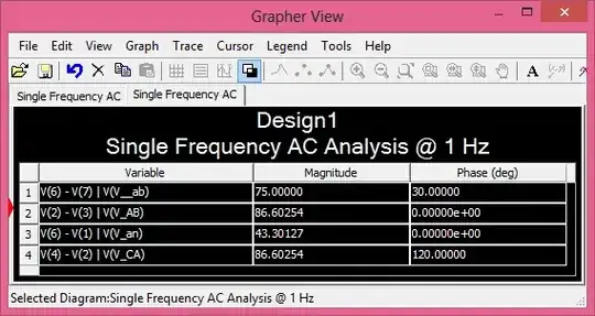

The following simulation proves the connection diagram is correct.
Simulation setup for Dy11
Simulation results for Dy11
from which
\$ \begin{align} \delta &= \theta_{\tilde V_{{\text{AB}}}} - \theta_{\tilde V_{\text{ab}}} \tag*{} \\ &= 0° - (30°) = -30° \equiv 330° \end{align} \$
and so \$ \text{index} = \dfrac{330°}{30°} = 11 \$; this demonstrates the connection diagram provided by EEP webpage is correct.
