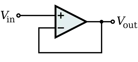

Most Basic Interpretation:
Here is my intuitive way to understand a given op amp circuit by personification. Picture a little dude inside the op amp. The little dude has a display that indicates the difference in voltages between the + and - inputs. The little dude also has a knob. The knob adjusts the output voltage, somewhere between the voltage rails.
dude
The goal of our little friend is to make the difference between the two voltages zero. He will turn the knob until he finds the voltage on the output that, based on the circuit you connected to it, results in zero difference on his display.
So in "sequential" steps:
  1. The input to the buffer circuit is at 5V. Let's assume that the output knob is initially at 0V.
  2. Since the input is connected directly to the output in the buffer configuration, the difference that is on the little dude's display is 5V. He is not happy about that.
  3. The little dude starts turning the knob to increase the voltage output. It keeps getting closer and closer.
  4. Finally, when he sees 0V on the display he stops changing the knob. The output will now be at 5V.

It is not actually a little dude inside an op amp: it's math! Here is a representation of what we are trying to implement in an op amp:
This will achieve what the little dude was trying to achieve with some limitations:
  • The little dude could figure out which way to turn the knob, but this can't. We have to hook it up such that increasing the output decreases the difference.
  • There will be a tiny error if the "Lots of gain" is not actually infinity.
  • We have to consider carefully whether the circuit will be stable. There's quite a bit out there on this topic.

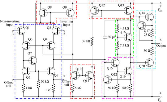

A Real Op Amp:
Here is what a real op amp (the 741) looks like on the inside:
op amp
These transistors implement the mathematical representation above.
