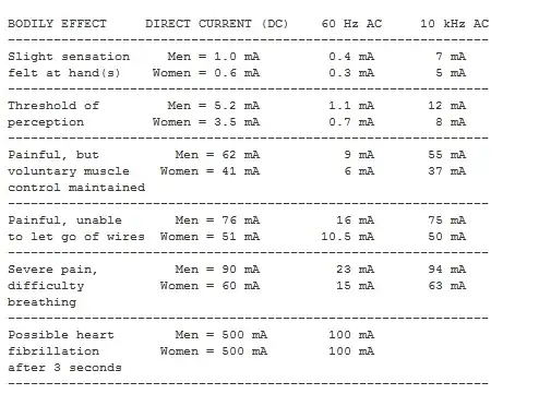

DC or AC (and what frequency) seem to make a difference too, female or male, etc - this table is very instructive:
Table1
Figures as low as 20mA across the heart are given as possibly capable of inducing fibrillation - here is another table from the same source that gives body resistance based on different situations:
Table2
You can see that as low as 20V may be dangerous given the right conditions.
Here is the reference the tables came from, I think it is quite accurate based on some experiments I have done myself measuring body resistances. The rest of the site seems to be generally very well informed and presented from the bits I have read, so I think this may be quite a trustworthy source.

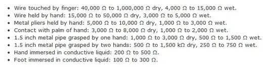

Carry a car battery with exposed terminals on a hot day when you are sweating and press the terminals to your body (as could happen worst case when lifting the battery, etc.), and you may end up repeating the experiment.
Once conduction into the body starts, you get a very low impedance/resistance circuit into what is essentially a large bag of dilute saline solution.

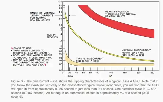

Earth leak circuit breakers (ELCB), also called ground fault interrupters (GFI) and other names, aim to trip at currents somewhere under 20 mA and in about 20 ms = well short of a heart cycle.
See graph below.
This article provides useful detail on GFCI operation.
Image from above article:
A shock from a circuit protected with an ELCB / GFI device will be felt but will USUALLY not be fatal.

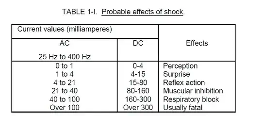

The table below is from this page -
A Summary of Surveillance Findings and Investigative Case Reports - Part I. Electrocution-Related Fatalities.
this is not a primary reference source but the figures used have been obtained from an "official" source. See above page.
Note that for 60 Hz AC ventricular fibrillation is stated as occurring at 100 mA, but paralysis of respiratory muscles occurs at 20 mA. These limits are very much user and situation dependent but give an order of magnitude indication.
With very informal equipment, I measured 1500 ohms resistance across two areas on my abdomen. I decided not to measure across my chest in the vicinity of the heart. I used flat contacts with no skin penetration. At 12 V, if resistance did not change with the current flow (and I'd expect it to probably drop), a current of 8 mA would be produced. Measurement with skin penetrating electrodes may reasonably be expected to increase this significantly.

According to Joseph J Carr's. "Safety for electronic hobbyists. Popular Electronics." October 1997:
In general, for limb-contact electrical shocks, accepted rules of thumb are: 1-5 mA is the level of perception; 10 mA is the level where pain is sensed; at 100 mA severe muscular contraction occurs, and at 100-300 mA electrocution occurs.
Electrocution becomes fatal when the current passes through the heart and causes fibrillation - the current causes the heart's beat to get out of sync and it can't pump blood any more.

I agree with the other answers about that is the current that kills, but most off the other answers forget that the internal resistance of a body is not constant.
  1. How big is the body, a child, a small woman and a big man do not have the same mass.
  2. Contact area, i.e. how moist is the skin and how thick is it.
  3. How far shall the current travel in the body, longer distance means higher resistance (just like any other cable out there). So there is a big difference if you have 2 wires connected directly to your chest or if one cable is attached to your hand and the other to your foot.
Then with this input you can calculate how big the current will be at the different voltages.

Department of Defense MIL-HDBK-454B "General guidelines for electronic equipment" says that current is what kills. From Guideline 1, point 5.2.1:
Shock hazards: Current, rather than voltage, is the most important variable in establishing the criterion for shock intensity. Three factors that determine the severity of electrical shock are: (1) quantity of current flowing through the body; (2) path of current through the body; and (3) duration of time that the current flows through the body. The voltage necessary to produce the fatal current is dependent upon the resistance of the body, contact conditions, and the path through the body. (See table 1-I). Sufficient current passing through any part of the body will cause severe burns and hemorrhages. However, relatively small currents can be lethal if the path includes a vital part of the body, such as the heart or lungs. Electrical burns are usually of two types, those produced by heat of the arc which occurs when the body touches a high-voltage circuit, and those caused by passage of electrical current through the skin and tissue. While current is the primary factor which determines shock severity, protection guidelines are based upon the voltage involved to simplify their application. In cases where the maximum current which can flow from a point is less than the values shown in table 1-I for reflex action, protection guidelines may be relaxed.
Table 1-I from MIL-HDBK-454B
MIL-HDBK-454B Table 1-I agrees with Table XXXIII in Department of Defense MIL-STD-1472G "Human Engineering".
