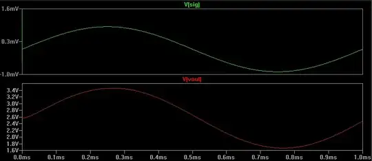

Something like this (some parts left out such as caps, etc) I set the opamp up with 6mV offset, you can see the difference in the simulation:
Sim without adjustment:
Sim with adjustment:

  • This has been really helpful. I am trying some different simulations, similar to yours. One thing I've simulated that I haven't tried in practice yet is to put a DC blocking cap in b/t your Vref and R2. I have read that by putting a blocking cap there, I will avoid amplifying my DC offset, which I think is my central problem. – Thomas Wilk Sep 18 '15 at 17:24
  • Also, I plan to use an LM350 voltage regulator to create my Vref. – Thomas Wilk Sep 18 '15 at 17:34
  • Yes you can certainly use the cap if you only need AC amplification (which I should have noted before), this should work fine. – Oli Glaser Sep 18 '15 at 20:51
