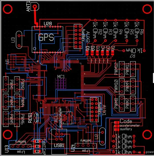

I'm making a drone, and would love if somebody can review my work on the PCB layout.
Image (red is top, blue is bottom, circles indicate holes and side transfers purple is glue):
PCB schematic
What is supposed to happen:
Input from the radios is PWMs 1-6, which is an RF receiver putting in the raw values of the control sticks.
The board is supposed to be able to be programmed via the ICE 10 component.
The MCU is going to be able to take input from the BMI055 (accelerometer) and GPS and validly parse that.
The Li-po inputs are for reading batteries, each wire (besides the first) is a cell.
The aux components are of no concern now.
PWMs 7-12 are the output, and go to a bunch of ESCs, which control the motors.
I feel I'm missing a bunch of passives; the PCB doesn't look like any other I've seen (in the fact that it only has a few resistors and 3 capacitors with advanced components).

    You are concerned about the lack of passives? Did you design this or just obtain a pcb layout? A schematic would be more helpful for understanding the lack of (or not) of passives. Post it if you can – crasic Sep 11 '15 at 03:52
    I added some links and cleaned up your post. Questions usually get more attention if you proofread them before posting. :-) – Adam Haun Sep 11 '15 at 04:15
  • You should start by maybe looking over the schematics of the crazyflie, as it is open source. No GPS, and it works with coreless DC motors. – RYS Sep 11 '15 at 05:47
    The 0603 footprints are way too wide, have some odd thin copper line between pads and also the pads are very close together. If you stretched them farther apart, you could route one track underneath. Check the hole diameter at AUX1 and AUX2. Use more track chamfering and fear not entering SMT pads form corners. Change mapping of PWM 1-6 to get cleaner layout. Check PCB manufacturer's annulus requirements. Use pin swapping on AUX1 and AUX2. Use the blue layer for ground pour and occasional short traces. Dump the THT resistors. Use SMT jumpers to keep most traces on the red layer. – venny Sep 11 '15 at 10:53

I'm not going to sugarcoat this; it's pretty bad. This project seems far too difficult for someone with your experience level. I recommend doing something simpler first to build up your skills. Try a basic microcontroller project to get familiar with the design/layout/soldering process, then move on to a simple wireless project, then maybe consider building your own drone from scratch.
Here are some specific problems I noticed:
  • None of your ICs have decoupling capacitors. The only capacitor I see on the entire board is the tantalum capacitor. This is especially horrifying since you have two high-frequency components -- a 66 MHz microcontroller and a 1.5 GHz GPS.
  • You are not following the layout recommendations in the GPS module's datasheet at all. There's an entire section on board layout guidelines, which I will quote almost in full here:
The module’s design makes integration straightforward; however, it is still critical to exercise care in PCB layout. Failure to observe good layout techniques can result in a significant degradation of the module’s performance. A primary layout goal is to maintain a characteristic 50-ohm impedance throughout the path from the antenna to the module. Grounding, filtering, decoupling, routing and PCB stack-up are also important considerations for any RF design. The following section provides some basic design guidelines which may be helpful. ...
The module should, as much as reasonably possible, be isolated from other components on your PCB, especially high-frequency circuitry such as crystal oscillators, switching power supplies, and high-speed bus lines.
When possible, separate RF and digital circuits into different PCB regions. Make sure internal wiring is routed away from the module and antenna, and is secured to prevent displacement.
Do not route PCB traces directly under the module. There should not be any copper or traces under the module on the same layer as the module, just bare PCB. The underside of the module has traces and vias that could short or couple to traces on the product’s circuit board.
The Pad Layout section shows a typical PCB footprint for the module. A ground plane (as large and uninterrupted as possible) should be placed on a lower layer of your PC board opposite the module. This plane is essential for creating a low impedance return for ground and consistent stripline performance.
Use care in routing the RF trace between the module and the antenna or connector. Keep the trace as short as possible. Do not pass under the module or any other component. Do not route the antenna trace on multiple PCB layers as vias will add inductance. Vias are acceptable for tying together ground layers and component grounds and should be used in multiples.
Each of the module’s ground pins should have short traces tying immediately to the ground plane through a via.
Bypass caps should be low ESR ceramic types and located directly adjacent to the pin they are serving.
A 50-ohm coax should be used for connection to an external antenna. A 50-ohm transmission line, such as a microstrip, stripline or coplanar waveguide should be used for routing RF on the PCB. The Microstrip Details section provides additional information.
  • Likewise, the MCU datasheet has a chapter on supply considerations. Here's their recommended schematic for using a single 3.3V supply. Notice the numerous capacitors. It's not directly stated, but you really ought to have a ground plane for a high-performance microcontroller.
Figure 6-2. 3 Single Power Supply Mode
  • Your crystals are way too far from your MCU.
  • How are you planning on soldering this? That accelerometer is 4.5mm x 3mm, and none of the pads are accessible once it's in place. You'd need a reflow oven, a steady hand, and maybe a solder stencil to even get it on the board. The 144-pin MCU won't be trivial either -- the pitch on those pins is 0.02 inches.
Fixing all this would require a four-layer PCB with careful attention paid to component placement, decoupling, and (especially) the integrity of the GPS signal. Unfortunately, this is not trivial, and it's not something you can learn in a few days. If you want to learn more, you might check out Henry Ott's Tech Tips page. It's mainly for EMC, but much of the material applies to high-frequency design in general.
If you are very, very lucky, your layout might work as-is. But I wouldn't count on it.
Sorry to be the bearer of bad news.

    To add to this post, ATMEL always has a document named **Schematic Checklist** for each MCUs series. There is for you: [link](http://www.atmel.com/Images/doc32130.pdf). There is also document for crystal placement [link](http://www.atmel.com/Images/doc8128.pdf) – Sergii Sep 11 '15 at 05:28
    I knew it would be bad. Like i said, this is my first project, and it didn't look anything like any board i'd seen. –  Sep 11 '15 at 11:49
    @Sergii Thanks for the info, I found it very helpful. –  Sep 11 '15 at 14:24
    Something else: Try to avoid 90-degree traces. They increase the risk of catching on something and being torn up, either during assembly or normal use. There are also some signal integrity issues with right angle traces, but they are generally not as critical. Use 45-degree angles instead of sharp corners. Also, you should widen your power traces and any high-speed traces. Keep your text going in one direction if possible. If you need two directions, rotate 90 degrees. Much of your text is rotated 180 degrees which looks sloppy. This is not critical but makes it more pleasing to the eye. – DerStrom8 Sep 11 '15 at 18:24
    I would also recommend a couple of ground pours. Avoid routing traces that go off at some strange angle (for example, the trace going to the Antenna). Keep them straight or at 45 degrees. Do not put text under components. Once assembled you may still need to read designators/values. You can't do that if there's a component covering the text. Keep text away from vias (unless you plan on specifying solder mask tenting). Try to keep traces as short as possible. Avoid traces that loop around or cross the entire board. – DerStrom8 Sep 11 '15 at 18:28
  • I read up on ground pours just now! I had no clue that certain components worked like that. –  Sep 11 '15 at 21:10
  • Where can I find out more about the physics behind why such capacitors are needed? – Alec Teal Sep 12 '15 at 03:34
    @AlecTeal Search for "decoupling capacitor" on this site or elsewhere. It's less physics and more circuit theory. The short version is that ICs tend to draw large currents for very short amounts of time, and the parasitic inductance of the power supply connection prevents it from keeping up. Decoupling capacitors act as short-term voltage sources. – Adam Haun Sep 12 '15 at 04:18
  • 90-degree traces reminded me of something. For any of the high speed digital or RF sections try to only have tracks on other boards pass one another at 90-degrees. This helps to minimise the cross talk between tracks. – TafT Sep 14 '15 at 09:11

Adam Haun covered your PCB design perfectly but one more comment about the design itself.
Your drone won't fly with just an accelerometer. You need to get your drone position but accelerometers only give you a value proportional to the acceleration in each direction. You need a gyro and use the accelerometer for the gyro drift compensation. The gyro and the accelerometer are the must-have but I'd add a magnetometer too. There's quite a few 9-DOF IMU chips available.
Alexxx
  • 909
    The BMI 055 is not only an accelerometer, by a gyroscope aswell :-). can you suggest a good magnetometer for me? –  Sep 11 '15 at 14:13
    Right. I missed that. A lot of the of-the-shelf flight controllers use the HMC5883. But since it's sensitive to the magnetic fields I would not put it on the PCB itself or anywhere near the ESCs. You can buy the GPS+magnetometer/compass combo modules really cheap nowadays. You'd just add connectors for both on your controller board. – Alexxx Sep 11 '15 at 15:38
