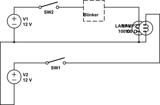

I have a motorcycle headlamp that I am lighting outside of a motorcycle. It's a stage prop, I have the front end of a motorcycle built as my microphone stand. The bulb has hard set 3 terminals, two leads and 1 common out. I am wanting to put a blinker on one of the lights (high beam) and have a switch just for on and off on the other light (low beam).
I am wondering if I am running into a problem where the common terminal on the light comes out and I have to split the cable to run to the two negative terminals. Will the current split and distribute amongst the two? Will this work ok? I have the two power supplies to provide enough amps to run both of the lights. By the way, this is DC Current. Thanks so much for your help.

Your setup will work fine. KCL states that each supply will take back from the negative only as much current as they put out on the positive.
