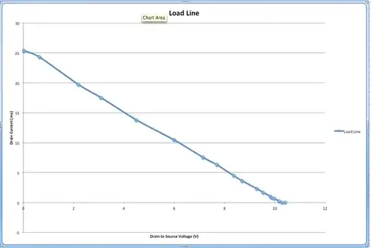

Here is the load line that I plotted of my circuit.
Now, from what I've gained from the answers here is that in order to operate the MOSFET as a switch, the operating point should be towards the left of the load line. Am I correct in my understanding?
And If one imposes the MOSFET characteristic curves, on the above graph, then the operating point would be in the so called "linear/triode" region. Infact, the switch should reach that region as quickly as possible in order to work efficiently. Do I get it or am I completely wrong?

    Yes in order to operate as a switch the MOSFET should be in linear/triode region and yes you want to get to that region as fast as possible in order to minimize loses. – mazurnification Sep 01 '11 at 16:23
  • Thank you very much. And finally, if one makes an analogue Class A amplifier out of a MOSFET - he would be operating in the "saturation" region? The operating point ought to move WITHIN the saturation region on the load-line? – Saad Sep 01 '11 at 16:26
    Yes, that is correct - for the Class A amplifier the MOSFET should operate within saturation region. – mazurnification Sep 01 '11 at 17:07

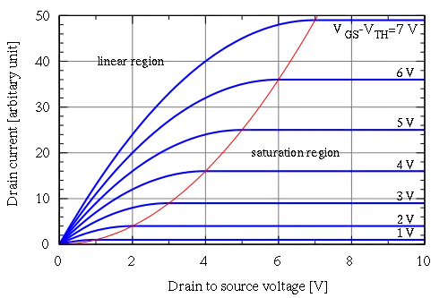

The datasheet for a MOSFET will show a graph with curves showing a particular \$I_D\$ for a particular \$V_{DS} \$ at a particular \$V_{GS}\$, usually for a number of different \$V_{GS}\$ values.
MOSFET Id vs Vds curves - from Wikipedia MOSFET article
In this example, the red parabolic line separates what's referred to as the 'linear' region from the 'saturation' region. In the saturation region, the \$I_D\$ lines are flat - the current does not increase any more as \$V_{DS}\$ increases. In the linear region, as the drain current increases, \$V_{DS}\$ increases - the MOSFET acts sort of like a resistor.
In your situation, assuming your part has similar curves to the example, technically 'no', the device is not in the saturation region. That being said, your \$I_D\$ is so low that the \$V_{DS}\$ drop is miniscule compared to the series resistor. No matter what \$V_{GS}\$ rises to, the 'linear' drop of the MOSFET is tiny compared to the \$390 \Omega\$ resistor, and "looks" saturated.

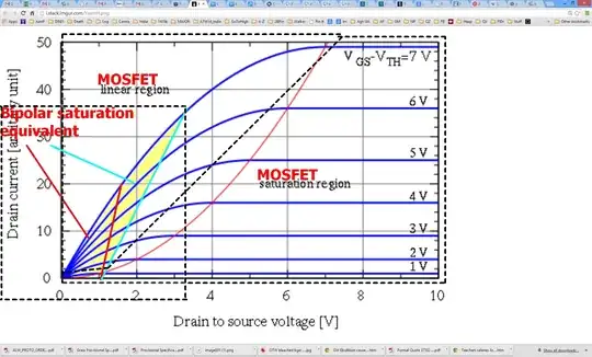

Vth gives an indication of how much voltage is going to be needed to operate the FET as a switch BUT actual fully-enhanced Vgs is typically several times Vgsth. Also, Vgs required for full enhancement varies with desired Ids.
This graph, copied from Madmanguruman's answer, shows that at Vgs = 7V the Ids/Vds realtionship is about linear up to about Ids = 20A so the FET is "fully enhanced" and looks like a resistor up to about this point. For this FET Vds is about 1.5V at about 20A so Rdson is about R = V/I = 1.5/20 = 75 milliOhms.
For this FET there is a curve at Vgs = 1V so VGSth = Vth is probably in the 0.5V-0.8V range at say 100 uA.
