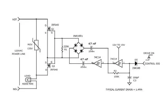

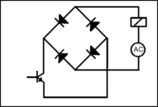

(1) Place a MOSFET inside a 4 diode bridge as the "load". Ac to bridge AC input is "shorted " = on for AC when FET is on Gate is floating so you need to get voltage to gate. Not hard but needs thought. Rough diagram - better later maybe. Transistor shown here is bipolar but MOSFET does same job. MOSFET always sees DC. Load sees AC switching. Drive gate with opto. Derive power by eg resistor feed from drain to a reservoir cap to drive gate via opto.
(2) Two eg N channel MOSFETs in series - connect source to source and gate to gate. Inputs are 2 x drains. Drive gate +ve to source to turn on. Gates to source to turn off. Again, gates and sources float so you need to get drive to them but not hard - just needs thought.
The circuit diagram below shows an example of a practical implementation of this principle.
Note that the FETS are both N-Channel and that the Sources of both FETs are connected and the Gates of both FETs are connected. This circuit works because MOSFETS are two quadrant devices - that is, an N channel FET can be turned on by a positive gate realtive to source regardless of whether Drain to Source voltage is +ve or -ve. That means that the FET can conduct "backwards" if driven in the normal manner. Two FETS are required connected in "anti series" (opposite relative polarity) because of the "body diode" inside each FET which conducts when the FET is biased oppositely to usual. If only one FET was used it would conduct when the FET was turned off when Drain was negative relative to source.

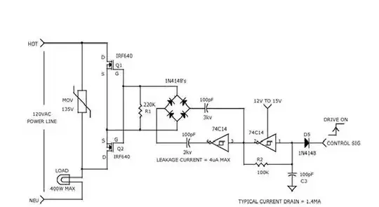

Note that "isolation" and level shifting of the on/off signal to the floating gates is achieved by the 2 x 100 pF capacitors. Consider the circuitry at right as potentially at mains potential. The right hand 74C14 forms an oscillator at about 100 kHz and the two inverters between them provide opposite polarity drive via the 2 capacitors to the 4 diodes which form a bridge rectifier. The rectifier provides DC drive to the floating FET gates. The gate capacitance is probably ~ a few nF and this is discharged by R1 when the drive signal is removed. I'd guesstimate drive removal would occur in tenths of a mililsecond but do the calculations yourself.
The circuit is from here and notes
  • The circuit uses an inexpensive C-MOS inverter package and a few small capacitors to drive two power MOS transistors from a 12v to 15v supply. Since the coupling capacitor values used to drive the FETs are small, the leakage current from the power line into the control circuit is a tiny 4uA. Only about 1.5mA of DC is needed to turn on and off 400 watts of AC or DC power to a load

    5A x 2 diode drops = 1 hot bridge. Neat trick, just not sure I'd want to push all that much current through it. Anyway +1 on you. – JustJeff Aug 31 '11 at 23:56
  • I think this should be split into multiple answers – endolith Sep 01 '11 at 05:28
    @endolith - serious question - why split it? This is all on his topic AND forms a single point resource for others. – Russell McMahon Sep 01 '11 at 06:10
    @Russell McMahon: Thank you very much for sparing your effort of writing this long answer. My circuit will switch the voltage on the secondary winding of a transformer. This voltage will directly be switched to a filter (capacitor), then to a regulator stage. In your circuit (1), can I use a PNP BJT or P-channel MOSFET, and connect the filtering capacitor (and the regulator stage parallel to it) on the low side? In your circuit (2), what did you mean by "gates are floating", gate driving looked OK to me. What improvements should I do on that circuit? Thank again, and thanks in advance. – hkBattousai Sep 01 '11 at 07:14
    @RussellMcMahon: Because there are several different solutions here. They should be in different answers so we can vote each one up or down and comment on each independently. – endolith Sep 01 '11 at 13:33
  • @hkBattousai - In cct 1 the load can be in SERIeS with the transistor inside the diode bridge - BUT NOT in parallel with the transistor - ah - you may mean the regulator is in parallel with the cap - yes. You have now "invented" a std switched DC power supply - try redrawing it :-) // P Chanel FET or PNP can be used with proper drive. // Floating means that relative to ground as AC sees it the gates vary in voltage with the AC, even though relative t the sources the gates are at a fixed value. Draw cct and plot some voltages. – Russell McMahon Sep 01 '11 at 14:12
  • @endolith - I'm here to try to answer useful questions usefully. Others can split up their questions to maximise voting outcomes if it please them :-). Very hopefully people will not seek to splt up mine by editing. – Russell McMahon Sep 01 '11 at 14:14
  • @RussellMcMahon: I said split up the *answer* not the question. You have 3 different answers here. – endolith Sep 01 '11 at 23:56
  • @endolith - sorry yes, split up answers is what I was referring to. There are 3 circuits but it's all one "answer". As I said, together they form a potential resource that allows ease of comparison, internal reference etc. I'm very happy for such things to be done as a whole. – Russell McMahon Sep 02 '11 at 00:17
  • @RussellMcMahon: What frequency is circuit #2 capable of switching? Can it be used for an AC dimmer for resistive loads? – Bryan Boettcher Mar 08 '12 at 23:33
  • I see "the man with no name" is back. I thought we'd laid him to rest after he made his ID somewhat obvious . Apparently not. +11/-1. "This answer is not useful". Yeah, Right. – Russell McMahon Jun 29 '12 at 17:08

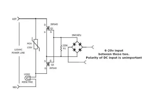

I might suggest some revisions of the version offered by @Russell McMahon that uses the 74C14 IC to drive the on and off function, if accepted. I like this design as it makes use of a bridge rectifier in an unusual way and it seemed quite sound until I put it to test. I used the IRF640 and the 220 kΩ between Gate and Source. The thing that made it work just right for me was to change the 100 pF capacitors for 47 nF capacitors.
At that point, I could put as low as 1 kHz in to the capacitors and get the FETs to fire (though 2+ kHz works better and up to about 22 MHz).
So if you modify this circuit as I describe, you will still need to put the FETs on a heatsink, absolutely.
To be clear, I was not testing this with the 74C14 but rather with my Signal Generator as the input, for sake of bench testing the functionality of this model of power controller components.

Final EDIT (I think): Below is a version that I tested with a standard 9 volt battery but you much use some DC or AC source that is within spec for the GS voltage of your MOSFETs and high enough to turn them on after the bridge PLUS, and this in really important, do not use a supply or source that has ground from the line (120 volt line) and negative of the output bonded. You will break something!

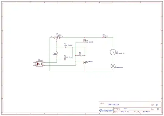

Edit Jan 1 2022: Just completed and tested the best version yet and I love it! I hope this is the best answer for this thread or at least someone may have a great solution if they don't have access to high-power TRIACs and though they make it quite simple, I think this is a very simple way to build with power MOSFETs instead. Please ask questions if you like. This version is isolated and works like a charm. Should turn and off very quickly
Isolated MOSFET-based SSR
