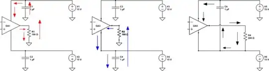

The purpose of bypass capacitors is to provide a low-impedance close to the chip (bypassing any series inductance to the supply rails). Since most op-amps do not have a ground pin the internal circuitry does not care about the ground level, however when you apply a load to ground the current path is from the positive or negative supply, through the circuitry on the chip, out the output and through the load to ground. A capacitor from the positive and negative supplies will make sure that loop is physically small and thus low inductance.
The left two schematics show an op-amp driving positive and negative current into a load connected to ground, and how the bypass capacitor appears in the loop. The right hand one shows a load connected to the negative rail. The capacitor in the right hand schematic is twice as effective with the load connected this way (1uF rather than 500nF) and it saves a part.
