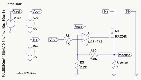

I'm looking for a MOSFET driver circuit that can be placed between an op-amp and a power MOSFET to operate the transistor as a linear amplifier (as opposed to a switch).
Background
I'm developing an electronic load circuit that must be able to step a load in about 1µs. The most important step size is small, say 100mA, although once I get that worked out I'd probably like to also attain a large signal step speed of 2.5A/µs. It should accommodate sources from 1 to 50V, currents from 0 to 5A, and will be able to dissapate about 30W.
Here's what the circuit looks like at present. Since appearing in earlier questions I have replaced the MOSFET with the smallest capacitance device I was able to find (IRF530N -> IRFZ24N), and moved to a reasonably wide bandwidth, high slew-rate op-amp (LM358 -> MC34072) while staying in jelly-bean territory. I'm currently running a gain of about 4 on the op amp for stability purposes, which gives me a bandwidth in the neighborhood of 1MHz. Further background below for anyone interested.
The problem
While the circuit performs reasonably well, the problem now is that the stability is, well, not stable :) It doesn't oscillate or anything like that, but the step response can range from overdamped (no overshoot) to quite underdamped (20% overshoot, three bumps), depending on the source being loaded. Lower voltage and resistive sources are problematic.
My diagnosis is that the incremental input capacitance of the MOSFET is sensitive to both the voltage of the source being loaded as well as Miller effect produced by any source resistance, and that this produces in effect a "wandering" pole from \$R_o\$ of the op amp interacting with the source-dependent \$C_{gate}\$ of the MOSFET.
My solution strategy is to introduce a driver stage between the op-amp and the MOSFET to present a much lower output impedance (resistance) to the gate capacitance, driving the wandering pole up into the tens or hundreds of MHz range where it can't do any harm.
In searching for MOSFET driver circuits on the web, what I find mostly assumes one wants to "switch" the MOSFET completely on or off as quickly as possible. In my circuit, I want to modulate the MOSFET in its linear region. So I'm not finding quite the insight I need.
My question is: "What driver circuit might be suitable for modulating the conductivity of the MOSFET in its linear region?"

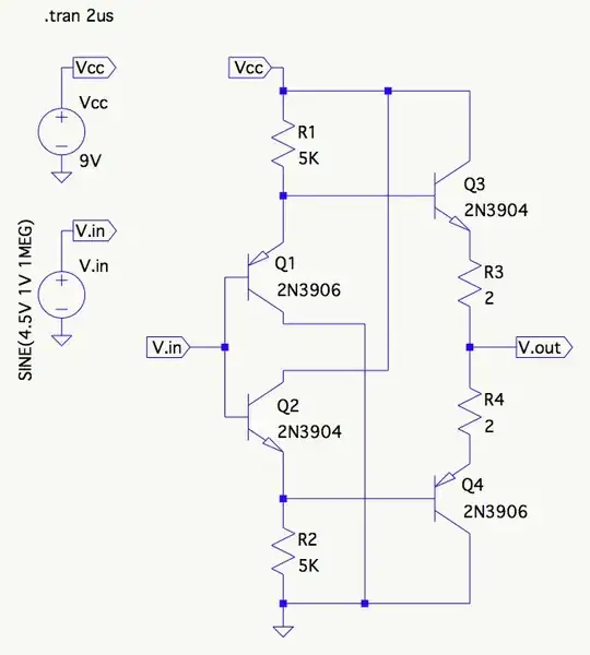

This is indeed an interesting problem, because of the variation of effective load capacitance with the load resistance due to Mr. Miller, and your need to not overcompensate it.
I suspect a biased push-pull BJT output driver would work fine- maybe 4 small BJTs (2 connected as diodes) a couple bias resistors plus maybe a couple ohms each of emitter degeneration.

Outcome Report
Okay, the short story is: adding a discrete buffer worked! That said, I don't think I'll design my circuit this way, rather I'll go with the recommendation of @Spehro and @WhatRoughBeast and just use an op amp with higher current output capability, basically having the buffer stage built right into the op amp.
Here's the circuit I used. Pretty similar to the one @Spehro provided, but actually exactly the one in the LH0002 datasheet that @gsills recommended. Basically it used exactly the same parts (bias resistor value 5k instead of 1k) just a few different connections, and ... the datasheet said the circuit had a current gain of 40,000; well, my gain greed totally took over and I decided to go for the two-stage version:
It simulated nicely so I built it up on a 5 x 7 bit of veroboard and installed it as a daughter board on my prototype:
And voila! pretty darn close to 1µs rise (1.120µs) and solid as a rock with no overshoot all the way from a little above 0V up to 30V and current steps from 100mA to 2.5A.
The fall is a bit longer at 1.42µs:
Now this was actually a bit of a pleasant surprise, because the circuit wasn't particularly stable on its own when I tested it on the bench before installing it. Who knew a buffer circuit like this could oscillate all on its own? Well, everybody except me apparently, I discovered once I searched on it :) And really high frequencies too, like 25MHz. I still don't completely understand why that is, but apparently an emitter follower is very close to a Colpitts oscillator, this circuit is a quad-pack of emitter followers, and just the wrong bits of parasitic reactance can set the thing singing. I expect my test leads were all the parasitics it needed. Also, some input resistance is used to settle it down (by "spoiling" the \$Q\$ of the tank circuit I believe), so perhaps the \$R_o\$ of the op amp helps with the solution too.
So this was definitely a rich learning experience. I finally got to really get my head wrapped around push-pull BJT amps and I'm really pleased with the circuit's performance now. I think I can get below 1µs by tweaking the gain to get a little more bandwidth, maybe a gain of 3 instead of 4.

While I generally agree with Spehro, there are a few things I think you should pay attention to.
First, you MUST add some decoupling to your power line. A 9-volt battery is not going to have the performance you need. Try about 10 uF, tantalum, as close to the amp as you can get. From the picture, it looks as if there may be an electrolytic serving this function, but you don't show it on your schematic. Even better, get a 12-volt (preferably linear) supply, and give up on batteries entirely. (You'll still need decoupling, mind, but at least you don't have to worry about the battery running low.)
Second, try connecting your scope ground to the grounded side of the power resistors, rather than the input wire. This should not make a big difference, but it's a good idea anyways.
Third, Spehro is being too gentle - your op amp won't do what you want. First, its settling time is listed as 1.1 usec to 0.1%, and that's without any exterior stages. Second, your gate is providing a 370 pF load on the output, and this is very likely a source of instability. With a nominal settling time of 400 nsec, particularly with a specified load of 500 pF, the LM8261 is a much better choice. A caution, though - the wider bandwidth of the LM8261 will allow the possibility of some other source of oscillation, so be prepared. The layout of your pcb looks tight enough that this shouldn't be a problem, but you never know.
Fourth, if you really hope to load a 50 volt supply to 5 amps, you must resign yourself to dissipating 250 watts. 30 watts is just wishful thinking. This will almost certainly require multiple FETs and a much larger heatsink, probably with forced air cooling.

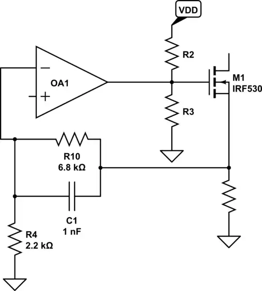

I would start by sticking a capacitor over the feedback resistor R10. Then adding a resistor divider for the mosfet, for the purpose of biasing the mosfet when it starts in its linear(triode) region.
The reasoning I have for this is: extremely many opamps oscillate without a capacitor for limiting bandwidth in the feedback loop. I personally consider it mandatory more often than not.
If the mosfet starts in its linear region, the opamp has the possibility of a good starting point, where it can slowly react to changes instead of suddenly reaching a treshold voltage. Just make the resistance large.
user55924
  • 720
  • I actually started with the "in-the-loop" compensation scheme you suggest. Unfortunately it kills the bandwidth when configured to accommodate the worst-case gate capacitance. It also makes the feedback circuit third-order, which may make the step response even slower. 20µs rise time was the best I could do with this scheme. The idea of the driver is to effectively isolate the op-amp from the MOSFET so no compensation is necessary and the maximum available bandwidth can be preserved. On the resistive voltage divider, I'm not sure I see the merit of giving the op-amp more to work against. – scanny Aug 27 '15 at 18:47
  • "Low-pass filter in the feedback loop." It looks more like a [high-pass filter](https://en.wikipedia.org/wiki/File:High_pass_filter.svg). – Peter Mortensen Aug 28 '15 at 09:33
  • @scanny ok, did you try a series resistor between the opamp and the gate? (around 50 ohms) and adding a second feedback loop?. (see AN-968 from ADI) – user55924 Aug 28 '15 at 15:14
    Yep, that was actually part of the original circuit (47Ω), but once the feedback capacitor was removed there was no longer any purpose for it and leaving it there would only add to \$R_o\$, moving the \$R_o + C_{iss}\$ pole downward in frequency and further degrading stability. – scanny Aug 28 '15 at 18:46
