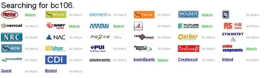

A useful site that allows you to search 20+ suppliers catalogs at once is www.findchips.com. Searching that site for BC106 returns
showing that 7 suppliers (probably) have it in stock - BUT it turns out that none of the stock are the transistor you want - the code BC106 appears in other parts numbers as well :-(.
