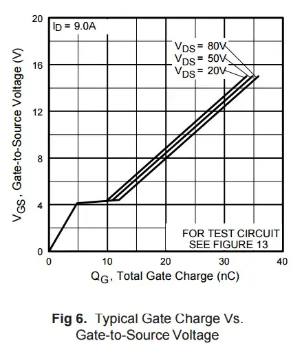

To get some insight into this, look at Figure 6 in the IRF530N datasheet (reproduced below), which shows the gate charge as a function of gate-source voltage. The definition of capacitance is \$\frac{\Delta charge}{\Delta voltage}\$, so given how this chart is laid out, the effective gate capacitance is the inverse of the slope of the curve at any given point.
IRF530N Figure 6
The \$C_{ISS}\$ value is measured at \$V_{GS}\$ = 0V, so it corresponds to the slope at the lower-left corner of the graph. But note how the graph flattens out near the threshold voltage — this reduced slope indicates a much greater effective capacitance (roughly 10×) at that operating point. And more to the point, this is exactly the point at which your current regulator circuit is operating.
So, to fully characterize the load capacitance your opamp is seeing, you need to test the MOSFET in the manner shown in Figure 13, with suitable bias voltages on the gate and drain.

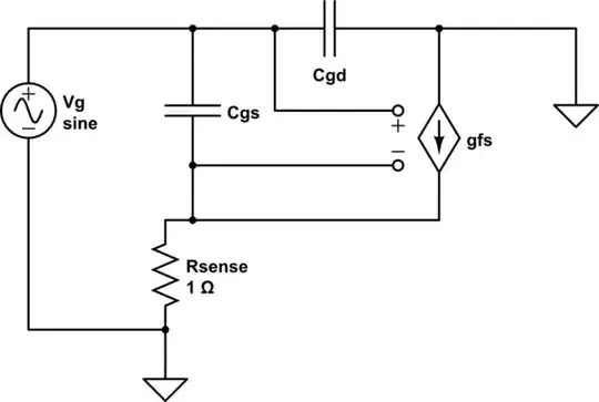

Let's derive an equation of \$C_{\text{iss}}\$ for a FET connected as in your circuit. Using a small signal AC model for a MOSFET such as Sze's 6 element model:
Here I've discarded the elements for \$C_{\text{ds}}\$, \$C_{\text{bs}}\$ (bulk capacitance), and \$R_{\text{ds}}\$ (drain to source leakage), because they're not needed here and just complicate things. Find for \$Z_g\$:
\$\frac{V_g}{I_g}\$ = \$\frac{g_{\text{fs}} R_{\text{sense}}+1}{s \left(C_{\text{gd}} \left(g_{\text{fs}} R_{\text{sense}}+1\right)+C_{\text{gs}}\right)}\$ \$\frac{\frac{s C_{\text{gs}} R_{\text{sense}}}{g_{\text{fs}} R_{\text{sense}}+1}+1}{\frac{\text{Cgs} s C_{\text{gd}} R_{\text{sense}}}{C_{\text{gd}} \left(g_{\text{fs}} R_{\text{sense}}+1\right)+C_{\text{gs}}}+1}\$
Now, the second fractional term doesn't do anything until frequency is well above 100 MHz, so we'll just treat it as unity. That will leave the first fractional term, the integrator term, which is the capacitive impedance. Then rearrange to get the effective \$C_{\text{iss}}\$ that matches the topology:
\$C_{\text{iss_eff}}\$ = \$\frac{C_{\text{gd}} \left(g_{\text{fs}} R_{\text{sense}}+1\right)+C_{\text{gs}}}{g_{\text{fs}} R_{\text{sense}}+1}\$ or \$\frac{C_{\text{gs}}}{g_{\text{fs}} R_{\text{sense}}+1}+C_{\text{gd}}\$
Note that here \$C_{\text{gs}}\$ is divided by \$g{\text{fs}}\$ (and \$R_{\text{sense}}\$) , hence obscured by transconductance, and \$C_{\text{gd}}\$ is added unmodified. Also, if \$R_{\text{sense}}\$ = 0, \$C_{\text{iss}}\$ = \$C_{\text{gs}}\$ +\$C_{\text{gd}}\$.

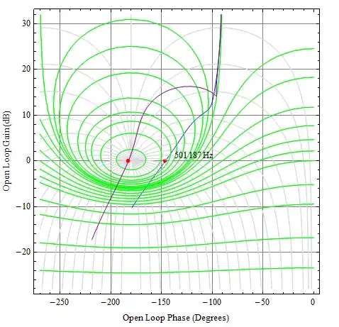

Let's look at the response. I'll use a Nichols chart here because that will show open loop and closed loop response simultaneously.
Here, the rectilinear grid is the open loop, while the contour lines show the closed loop (green contours for dB magnitude and gray contours for phase). The blue curve is \$V_{\text{ds}}\$ of 25V, and at the crossover point (at the red dot -- 502kHz), phase margin is indeed \$35^{\circ }\$, and closed loop peaking of about 5dB.
The purple curve is for \$V_{\text{ds}}\$ of 3V, and the corresponding open loop phase margin is ~ \$-3^{\circ }\$. For the closed loop, look at the ascent of mount Nichols, the curve pretty much nails the peak which would ideally correspond to infinite peaking. Of course that won't happen, but the system would be unstable.
It is no surprise that the main problem here is the open loop output impedance of the LM358. Even with a FET-circuit topology that has minimal expression of \$C_{\text{iss_eff}}\$, the LM358 is not adequate. An amplifier with open loop impedance of 50 Ohms or less and phase margin greater than \$75^{\circ }\$ would probably solve the stability problems.
