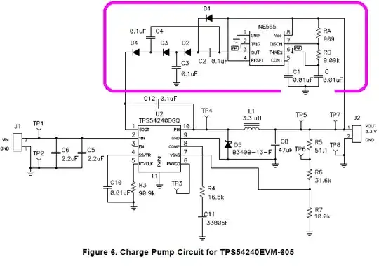

The TI application note addresses the issue that "self-pumped" bootstrap circuits have an upper limit for duty cycle, because the high side bootstrap capacitor needs time to recharge. So, a separate charge pump is added, which takes over from the bootstrap circuit.
enter image description here (also fig.4 in the app note)
The concern about exceeding the voltage rating for VGS is a valid concern. The gate of the MOSFET is may see the charge pump voltage when D < 1. Notice that the charge pump doubler in the app note is powered from the +3.3V output, so it generates a modest voltage.
