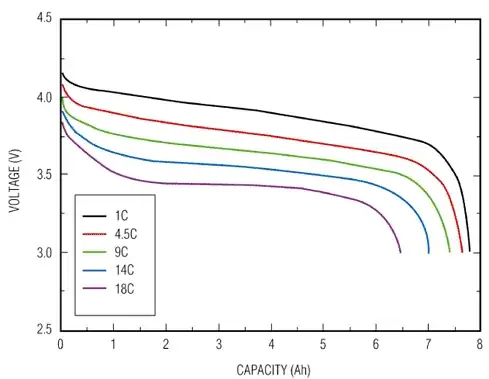

You should end up with something like this when you plot your results (note the x axis is in Amp hours:
Li-Ion capacity graph at various discharge rates
C is the discharge rate needed to discharge in 1 hour, so for a 1000mAh battery 0.1C is 100mA, 1C is 1A, 18 C is 18A. You can see how the capacity drops at higher discharge rates. NOTE - (as Russell mentioned) do not attempt to discharge at large currents (e.g. much above > 1C) unless you are absolutely sure the battery can handle this (e.g some camera batteries and RC batteries can discharge at huge rates) The above pic is only meant to be an example of discharge curves.
