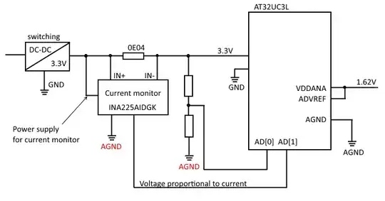

I want to measure current and voltage of switching power supply that is on board together with ATMEL AT32UC3L microcontroller.
I think I understand how to measure - using resistor divider to lower voltage so it does not exceed ADVREF, and to use current monitor IC that will convert current across shunt resistor into proportional voltage.
What I don't understand is how to connect resistor divider and current monitor grounds. Should they be connected to analog or digital ground?
If I connect them to analog ground, will I not introduce noise to it?
If I connect them to digital ground, will I have correct values as AD[x] inputs measure against AGND?
Or there might be other solutions?
Thanx for advice.
Sergii

    You have these two grounds connected together at some point, I hope? I would connect it to `AGND`, as the main circuitry of the part is analog. – Eugene Sh. Aug 17 '15 at 17:22
  • Well, I have not yet. Analog is not a main part, there are I2C bus with memory and digital potentiometer and probably I2C thermometer. – Sergii Aug 17 '15 at 17:25
