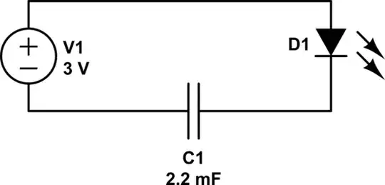

My components are
  • 2x 1.5 V batteries
  • 25V 2200uF capacitor
  • 3v Led
  • copper cables
My circuit looks like the following.
My understanding here is that as the two batteries are in linked in series, we now have 3v for our circuit.
When completing the circuit the LED starts bright then slowly fades and fades until there is no light at all. Also interestingly if I dissconnect the batteries, wait a minute, and reconnect them completing the circuit, the LED stays off - It does not start bright and fade again.
What is actually happening here? Is the capacitor consuming all the power? If I left this circuit complete for a while, would the capacitor gradually consume all the power until it reaches its 25V and then suddenly release 25V instantly? (blowing the LED of course)
I actually ran this test because I wanted to try to fill the capacitor up, and then dissconect the batteries hopeing to see the LED stay alight for a while running from the capacitors consumed power.(if this is even possible, perhaps my understanding is not correct)

  • [1] Draw a schematic of your circuit (wiring diagram which you drew doesn't count as a schematic, although it's a start). EE.SE has got a built-in schematic editor. Maybe the answer will jump at you. [2] You've got a polarized capacitor. Be sure not to reverse the polarity of this capacitor, otherwise it will blow up. – Nick Alexeev Aug 12 '15 at 03:22
    You absolutely have to connect the LED through a 100-200 Ohm resistor. It is not negotiable - if you have a LED in your circuit have a resistor, period. – ilkhd Aug 12 '15 at 03:57

As cowbydan stated, placing the capacitor in series to the LED will block DC currents. To achieve the desired effect of a glowing LED after removing the batteries you need a circuit similar to this :
The capacitor needs to be in parallel to the LED and the polarity of the capacitor needs to match the polarity of the connected battery. The resistor R1 is not mandatory in your particular application but it reduces the current which the LED consumes. A larger resistor value will increase the time the LED glows after you remove the battery but will also decrease its brightness. Just test it with some different values. Choosing a LED with a lower voltage rating would require a resistor in series to it to reduce the voltage.

Your capacitor is connected in series with the LED instead of in parallel with the anode. The "fading" is the AC coupled impulse from connecting the battery to the capacitor. Capacitors block DC current, so you are starving the LED for current.

A capacitor acts kind of like a break in the circuit, so no current could flow through your circuit. How is it then, that your led lights up for a short time?
A capacitor has other characteristics, when you apply DC to it, it starts to charge. Charging means, that is slowly attempts to reach the supply voltage. (3V in your case) the 25V on that capacitor is the maximum voltage you can apply to it before it blows up.
So because your capacitor stores electrical energy(charge), when you charge it, it lets current flow, this current causes the led to light up. But as the voltage on the capacitor increases, the less current flows, and the led will fade.
Why doesn't this happen after disconnecting and reconnecting? Because the capacitor kept its charge. Capacitors don't magically discharge, when they are charged they act like small fast-depleting batteries. You could discharge your capacitor by shorting it with a small value resistor(not with a wire, as that could cause it to be damaged). Then the led would start fading again.
Why doesn't your LED light up again when you disconnect the battery? Because you leave the other end of the led disconnected. If you would connect it to the capacitor with correct polarity, it would light up. (it would need reverse polarity, because currently the positive side of the capacitor is connected to the negative side of the LED.) BUT DON'T DO THIS WITHOUT A RESISTOR, limit the current flowing thorough your LED.
