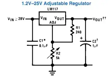

Several people have correctly pointed out that the LM317 output voltage is affected by the Iadj current which flows in R2 (see example circuit below).
Two factors are potentially relevant for Iadj - its absolute values of 50 uA typical, 100 uA maximum, and its variation across the load range of 0.2 uA typical, 5 uA maximum. As others have noted, R2 need to be small enough such that Iadj voltage drop in R2 can be ignored or it must be allowed for. If R2 is large then the change in Iadj through R2 under load may be significant. For example, if Iadj changed by it's maximum value of 5 uA across load and if R2 was 100k (much larger than usual) then the change in Vout would be V=I.R = 5 uA.100k = 0.5Volt! Even a 20k here would cause a change of 0.1 Volt, which may be of concern in some cases. (If it was then you should probably not be using a simple 3 terminal regulator, but that's another story).
Typical LM317 voltage regulator
Less subtle issue: There is a second less subtle but sometimes overlooked factor. The LM317 internal electronics are "operated" by the dropout voltage across the regulator and a minimim current MUST flow through the regulator to achieve regulation.
The LM317 datasheet specifies 10 mA max, 3.5 mA typical as the minimum load current (on page 4 of the referenced datasheet). (A maximum minimum is a nice concept :-)). 'Proper' design requires that 10 mA worst case be allowed for. IF the external load always draws 10 mA or more then all is well. However, if external load current can fall to below 10 mA then the design must provide a load to provide this 10 mA. Worst case, with no load, R1 provides a convenient way of providing the 10 mA while also providing a nicely "stiff" divider. R1 will always have 1.25V across it in normal operation. Using R1 = 240 ohms as shown in the datasheet example gives I = V/R = 1.25/240 = 5.2 mA which is more than the 3.5 mA typical minimum load needed but less than the 10 mA worst case minimum load needed. If there can be zero external load then you need no more than R=V/I = 1.25V/10 mA = 125 ohm for R1 if this is the way you obtain your minimum load current. SO the 240 ohm resistor shown for R1 would not meet the LM317 minimum load requirement worst case. Either a lower value of R1 must be used or a minimum external load suitable to bring the total up to at least 10 mA must always be present.
With R1 set, R2 can now be dimensioned to achieve the desired output voltage. With 10 mA flowing in R1 + R2, Iadj is insignificantly small in all except critical cases.
When 'designing" a circuit (rather than just "making it work") it is essential that the worst case parameters are used. What constitutes 'worst" will vary with the parameter and, in some cases, you may have to use the mimimum value of a parameter for one design calculation and the maximum value of the same parameter for another calculation.

Others have already pointed to the equation
\$ V_{OUT} = 1.25V \left(1+\dfrac{R_1}{R_2}\right) + I_{ADJ}R_2\$
which also can be found in the datasheet. Rearranging for \$R_1\$ gives us
\$ R_1 = R_2 \left( \dfrac{V_{OUT} - I_{ADJ} R_2}{1.25V} - 1\right)\$
If \$V_{OUT}\$ is in the order of volts (most likely) and \$R_2\$ is in the hundreds of \$\Omega\$ the term \$I_{ADJ} R_2 << V_{OUT}\$ and can be ignored, since \$I_{ADJ}\$ is maximum 100\$\mu\$A. We get a simplified equation then:
\$ R_1 = R_2 \left( \dfrac{V_{OUT}}{1.25V} - 1\right)\$
For example for \$V_{OUT}\$ = 5V and \$R_2\$ = 100\$\Omega\$ the first equation gives us a value of 299.2\$\Omega\$, while the second gives us 300\$\Omega\$, an error of only 0.3%.
On the other hand, if you would pick 10k\$\Omega\$ for \$R_2\$ you would get values of 22k\$\Omega\$ and 30k\$\Omega\$ resp. for \$R_1\$. Using the 30k\$\Omega\$ would result in 6V out instead of 5V, an error of 20%!
There's another good reason to pick low values for \$R_1\$ and \$R_2\$. The datasheet mentions a minimum load of 3.5mA typical, 10mA maximum. It's better to choose 10mA, not only because you always have to calculate for worst case, but also because the 10mA is given as a minimum condition for the other parameters.
For 5V out you'll want \$R_1\$ + \$R_2\$ < 500\$\Omega\$ then.

The output voltage is determined not by the ratio of R1 to R2. It's given by the following equation:
\$ V_{OUT} = 1.25 \left(1+\frac{R_1}{R_2}\right) + I_{ADJ}R_2\$
For ordinary purposes, the \$I_{ADJ}R_2\$ term can be discarded, because \$I_{ADJ}\$ is on the order of \$100\mbox{ }{\mu}A\$.
You've multiplied your resistors by 10, so this error term will also be multiplied by 10, going from 33 mV to 330 mV, or 0.33 V.

You also have to take into account Iadj, which is around 100uA. As this remains constant at all times, but the I through R1 changes depending on it's resistance, you need to make sure that the 100uA is not a large part of the program current.
So the higher you have R1, the more "error" Iadj will cause, as it starts to become a significant part of the overall current.
With your example:
(1.25 * (1 + (330/200))) + (100e-6 * 330) = 3.3455V
With resistor x10:
(1.25 * (1 + (3300/2000))) + (100e-6 * 3300) = 3.6425V
