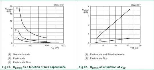

26
It makes sense that higher frequencies require lower resistance pull-ups: a lower resistance will charge/discharge the cable's capacitance faster, which results in steeper edges. With the wider pulses of lower frequencies a less steep edge won't influence the pulse's shape as much.
Therefore the I2C specification gives maximum values for the pull-up resistors as a function of bus capacitance for three speed classes:
The minimum values are defined in function of the bus voltage, and should limit the current through the drivers.

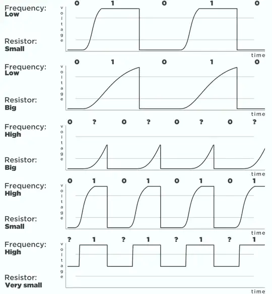

if you ask me the best thing is to look at each project with oscilloscope if you think it is critical. You can do the math, but... it is better to measure it :) because impedance (length of lines and so on) have a big factor.
There is a gif animation of effect of different values on my website:
https://small-roar.com/i2c-inter-integrated-circuit/
As you can see too small value results in not detecting of signal - with older MCUS like Atmega it is not a problem because they have high values for "logic low/high" + if you want low power application its not the best way to go.
