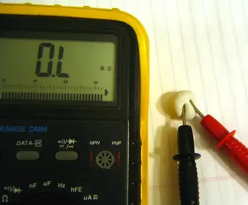

If you want something like clay, what's wrong with clay? Just check it to make sure it's not conductive. I think you'd have more difficulty finding conductive clay than non-conductive...
Here's Elmer's Tac 'N Stik, which is probably more like what you want:
sticky-tack measured with a multimeter
Also, here are instructions for cooking up insulating dough and conductive dough.
