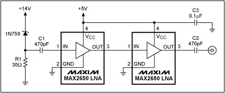

A good noise source is the breakdown noise of a zener diode. The simple schematic below shows how to get white noise from a zener by cascading two LNAs (Low Noise Amplifiers) to increase the noise level.
white noise generator
If you don't care about the noise being white you can simply use an opamp amplifier with a high amplification, with a comparator following it. The opamp's amplification puts a limit to the bandwidth, and hence the rate of change in your digital signal. If necessary cascade two opamps like the LNAs in the given schematic to get a faster random bit stream.
You can use the SPI module to clock in bytes of random bits from this circuit.
(The SPI is just a simple way to automatically collect 8 random bits, it doesn't add any level of determinism: the input changes continuously and randomly and you never know what it will be at the next clock edge. You can also read an I/O pin and shift that bit's level into your result byte.)

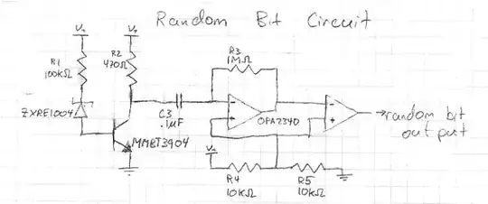

This circuit is a possible alternative solution, also relying on a zener diode as a noise source:
random bit circuit
The schematic mentions the OPA2340 for the amplifier, but isn't clear on the comparator. While the OPA2340 is reasonably fast I would suggest to use a real comparator here as these are usually much faster than opamps. For instance the TL3016 has a propagation delay less than 10ns, and a rise time of 0.5ns typical. This means you can sample random values faster without the risk of coherence between successive samples.

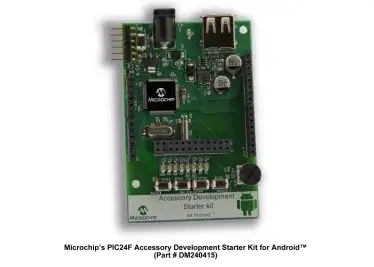

You're not using a PIC24FJ256GB110, which looks like this:
TQFP-100, not necessarily PIC24FJ256GB110
You're using an Android Starter Kit:
picture of board
which, as you understand, is a rather fixed PCB: You aren't designing the PCB, and a quick look at the schematic didn't reveal much that was built for or could be repurposed as a hardware entropy source, except some ADC traces that might function as antennas as suggested by Matt.
Assuming you're interacting with an Android device, though, you have three potential sources of random noise:
  1. You could measure the precise timings of asynchronous communications or communication happening on the Android, and use the lower bits of this measurement as a source of entropy. Note, of course, that this could be gamed by precisely controlling the Android device, and so isn't suitable for security applications.
  2. Use the lower bits of ADC reads to generate some random noise. You have several floating traces, so this should get unpredictable results.
  3. You have breakout headers to an Arduino shield! This means that you can add all kinds of hardware, like the solutions proposed by Steven, this shield, or the ones proposed in this question. Yes, this will require external hardware.
However, be aware that cryptographic security and true randomness is hard stuff. It sounds like you need to do some more reading before you try to produce something that people can depend on, or you could get yourself in some serious trouble.
