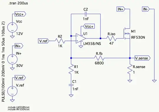

I'm working through the design of an electronic load, basically a power MOSFET driven by an op amp.
I simulated the loop gain frequency response like this:

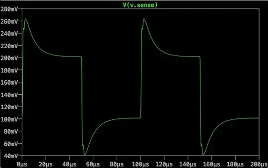

All very satisfactory so far, but when I switch to step response like this:
I get an output waveform with 60% overshoot on both the rise and fall:
What's up with that? I thought phase margin and overshoot were directly related. and expected something with a very small amount of overshoot, or perhaps none at all.

I think, you have simulated the loop gain correctly. The input impedance at the inv. input seems to be much larger than the combined source impedance of the remaining network. I recommend to make another test and select another point for placing the test signal source: Between the opamp output and the common node of C2 and Riso. The result should be (nearly) the same as in your first simulation.
However, I tend to Hypothesis 2 because the known relation between overshoot and phase margin applies to second-order systems only. However, your system is of higher order (opamp 2nd order, FET 1st or 2nd order, two external capacitors). More than that, the simulation results clearly show an enhancement of the phase caused by C1 (improving stability). The mentioned relation between time and frequency domain does not allow such a zero.
UPDATE: I think, the form of the step response confirms my analysis: It does not show a typical "overshoot" (which should exhibit some ringing for such a large peaking). Instead, it shows the typical form for a step response of a highpass (caused by the capacitor C1)

  • You were quite right @LvW; your observation about the overshoot sub-waveform was very insightful, I was wondering about the absence of ringing but didn't make the capacitive connection until you pointed it out. I ended up needing to remove *both* capacitors and abandon "in-the-loop" compensation altogether, and compensate by lowering the feedback percentage (raising closed-loop gain). I lost a little bandwidth but tuned it in at a very satisfactory 66.3° \$ɸ_M\$, 263kHz bandwidth, 2.8% overshoot, and 1µs rise time. I'll post details in a separate answer. Thanks again! :) – scanny Aug 07 '15 at 16:16

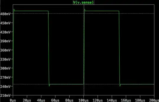

Outcome Report
Based on the accepted answer by LvW, I removed C1 to see if that would do the trick. Unfortunately no dice, as the waveform just changed to a different capacitive response:
However that was when I was sure LvW was right, and that using capacitors for compensation had to go. Who knew that using such a conventional compensation strategy could so negatively affect your step response? :)
I removed them both, along with \$R_{iso}\$, since there was no longer a need to isolate the gate capacitance, and adjusted the feedback resistors for a closed-loop gain of roughly 2.4.
and Voila!:
I was able to adjust the overshoot by manipulating the gain resistors, essentially moving the loop gain curve up and down to trade off bandwidth for phase margin. I settled on 66.3° \$ɸ_M\$, which yielded 263kHz bandwidth, 2.8% overshoot, and 1µs rise time. I want some extra stability in this particular circuit, and may even sacrifice a bit more bandwidth to achieve an extra margin of stability; a 1µs rise time is perfectly satisfactory for my purposes, and 2µs would be just fine too. I'll resolve all that on the bench.
