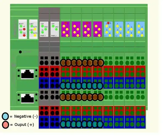

The component being used is a Phoenix ILB ETH 24 DI16 DIO16-2TX wired to support simple outputs and inputs using the image below:Input wiringOutput wiring
I would generally feel to these as PNP/NPN but I think this only apply to a circuit using a transistor? Any explanation as to explain this type of wiring would be great as I understand the practical side but not the theory.

    I'm not really sure what you are asking, but I would call the inputs "Sinking", and the outputs "Sourcing", which is probably the most common configuration in general industry. – R Drast Aug 06 '15 at 15:28
  • It was a tad vague question as I'm not sure the best way of wording it but that sounds like exactly what I was I was hoping for, I'll have a google of them. Thanks! – Antony Pain Aug 06 '15 at 15:38

    Thanks guys! R. Drast you were spot on, I looked into Sinking Inputs and Sourcing Outputs and they were exactly the type or wiring I needed to write about. Apparently an input or output like this used to be achieved using PNP/NPN transistors connecting Load to Ground and viceversa which must be why I had those terms from people throwing them about the office. – Antony Pain Aug 06 '15 at 15:58

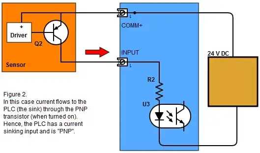

PNP - sinking input.
Figure 2 shows the PNP / sinking circuit. Here current flows from the + supply, through the transistor and the PLC "sinks" it.
The logic is the right way up now and this style of input is preferred on most industrial equipment at present.
