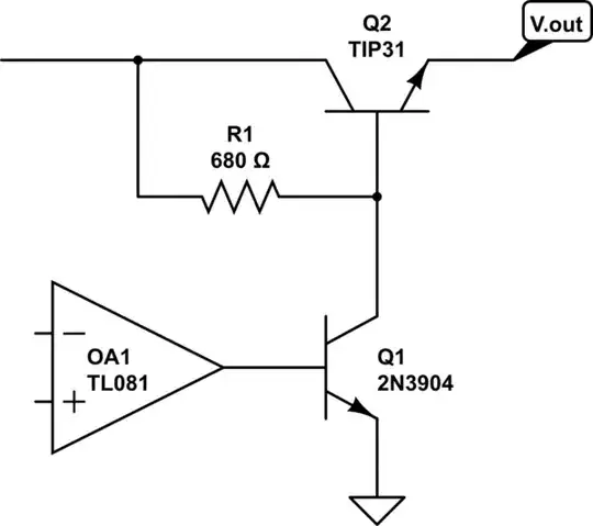

One vague notion I have for an application is in a linear voltage regulator I'm working on, where the op amp drives a transistor to sink current away from the pass transistor; conceptually like this (component values nominal):
This presents a stability problem because the op amp output voltage range is so narrow, roughly \$V_{BE}\$ +/- a few tens of millivolts to change the base current from 0mA to say 20mA. Maybe this is a good job for an OTA?
Am I on the right track? What intuitions about when to consider an OTA would enhance my design skill?

Regarding your voltage regulator: This is really a bad use-case for an OTA because you don't need the gain program-ability feature. You could build one using an OTA, but the cool feature of the OTA would not be of any use.
