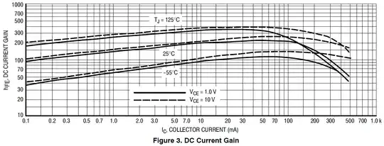

Do take note of the fact that it cites \$V_\text{CE}=10\:\text{V}\$. At this point, you may be tempted to use BF=220, or so. But let's look at the P2N2222A chart, which is more detailed:
Note that this covers \$V_\text{CE}=10\:\text{V}\$ and also \$V_\text{CE}=1\:\text{V}\$. Also, note that the curves aren't so flat. From this chart, I'd be more tempted to go with BF=200. Or maybe even less.
In practice (and I have 26,000 of these devices to play with, here), I find that \$\beta=200\$ is a good figure. But you will need to make a choice. At least, you can now see where to look when making that choice.
Something else that may not be clear to you is that in the first chart above, the one that only specifies the case with \$V_\text{CE}=10\:\text{V}\$, it includes an Early Effect in the computation. It's only in the lower chart from the P2N2222A, that you can see the value of \$\beta\$ without much applied Early Effect because it offers a curve for \$V_\text{CE}=1\:\text{V}\$.
