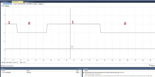

  2. Secondly, I write a C# program that demodulates any arbitrary FSK modulated signal. This program uses the Goertzel Algorithm and it fits like a glove for DTMF decoding and FSK demodulation. Basically, its output gives you the dominant frequecy in your reference frequecies(1200 and 2200 in our case) for your input signal.
Here are some screenshots from code and output result.
Input: The arbitrary sin wave I have created to simulate the code
Output: The output for the input signal above

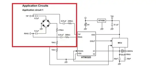

Here are some circuit that I think it is proper for my project. enter image description here
What is the output of the circuit in the red rectangle? Is it an appropriate signal for an MCU like Arduino or a for a PC?

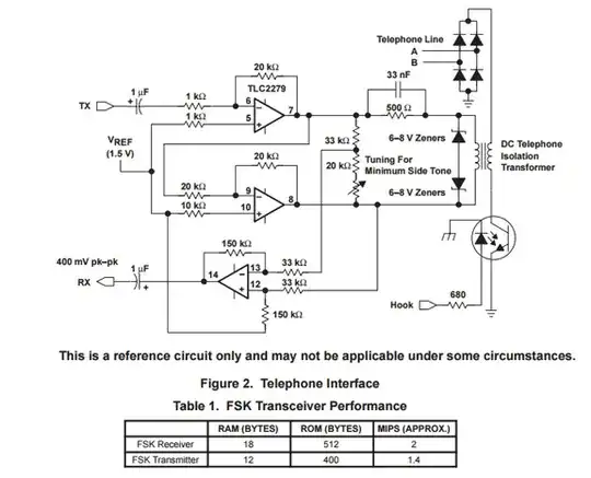

What about that circuit? According to this paper. RX signal is 1.2V DC biased and 400mv p-p signal and it propably carries our data we want, right?

    There is not a single reference to Caller ID in that TI document, you are just assuming it is fit for your specific purpose. You'll have to search for the Caller ID spec's in other documentation, not in a random application note that happens to use FSK modulation. But it needs to be said that I like your research efforts, it is a good way to learn things like this even if there is a chance that they may not work first time. – jippie Aug 05 '15 at 16:54
  • Hi jippie. Thanks for your support. I will be sharing all the process done. Have a nice day – Ebubekir Çağrı Şen Aug 05 '15 at 16:56
  • Also I think the 1.2VDC bias is for specifically for a 3V3 microcontroller as the MSP series. YMMV with other inputs. – jippie Aug 05 '15 at 16:57

Two of the line look like they will carry the signal that you're after, the ones that connect to the topr-right corner of the IC with the series resistor and capacitor, but you cannot/shouldn't connect them straight to you PC without:
  • knowing the expected signal levels of the signal you are interested in, the inputs must happily accept the signal levels;
  • protect the input against ring voltage, which can be up to several 100's volts peak to peak;
  • protect against overvoltage as a result of eg. lightning in the neighbourhood;
  • an insulation transformer for galvanic separation of the phone line/PC. (You can often find those in old modems or telephone sets.
