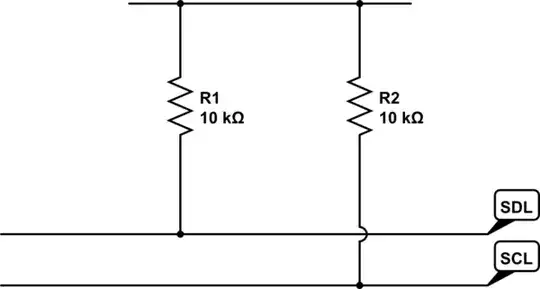

I want to establish I2C connection between two atmega2560. First one is working as a master, and second as slave. Master works on a transmitter mode, and Slave works as receiver.
On Master side: Master seems to work correctly, because all code comes from the datasheet. Master is able to send Start condition. When writing the Slave address, it receives a NACK from slave. When that happens, master tries to start from the beginning.
On Slave side: Slave is not able to recognize start condition, and TWINT flag never goes up. Which is why slave status register TWSR never updates and equals to 0xF8.
I'm using electrical schematic from datasheet, 2 pull-up resistors 10kOm. So maybe my slave code is not correct.

Problem was on slave addressing, i forgot to move address to the left in TWAR register. That is why my slave never send me an ACK bit, and also this is the reason why TWINT flag on slave never goes up.
P.S. Question was not correctly asked.
