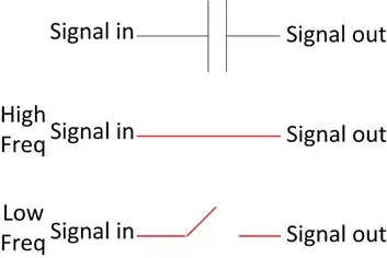

Let me see if I can add one more perspective to the other 3 answers.
Capacitors act like a short at high frequencies and an open at low frequencies.
So here are two cases:
Capacitor in series with signal
In this situation, AC is able to get through, but DC is blocked. This is commonly called a coupling capacitor.
Capacitor in parallel with signal
In this situation, DC is able to get through, but AC is shorted to ground causing it to be blocked. This is commonly called a decoupling capacitor.

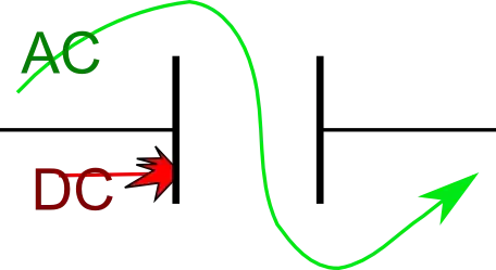

This is not a very technical answer, but it's a graphical explanation that I find very funny and simple:
