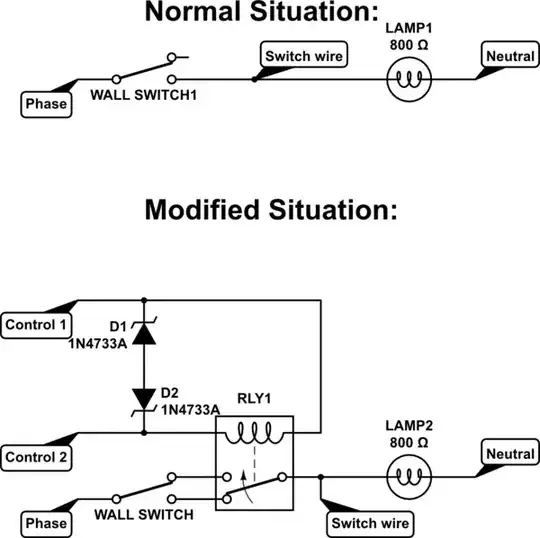

To expand Samuel's comment into an answer, if you use the normal mechanical wall-switch and make sure no wires get stuck anywhere you solve two possible issues:
  1. You have a nice standard-looking switch
  2. You can use dirty tricks to get your low voltage, because the switch already makes it safe.
What do I mean? Well, Samuel said, if I'm not wrong, do something like this:
In the modified situation, when it is as drawn, the light is off. When you flip the relay the light turns on. When you then flip the switch, it again interrupts the path.
If you make that relay a Latching Relay, such as these: EE2-5SNU NEC Relays you can change their connection with just a single pulse, which will not take much power if you keep the pulse short.
BEAR IN MIND! These are just an example I thought of, they are low current and not very high voltage (may do for light lamps or such, but no big halogen or high power LED lamps or Fluo's). But just to give you an idea.
You can then use a small non-isolated power supply, such as a dirty capacitor divider (they aren't allowed any more in production stuff, AFAIK) to get your low voltage.

  • @Asmyldof. Thanks for your great info. I probably should have mentioned that I want mechanical action of the wall switch to work exactly like before. I mean the switch has to work independent from wireless part too. Is your schematic taking care of this matter? – mostafanfs Jul 28 '15 at 05:31

    @mostafanfs The answer is yes, but I think, if you are going to fiddle around with mains wiring, it should be a nice exercise for you from the drawing of the switches to work out why that is. Since wiring up mains, especially routing the neutral that you will need if you want modern lighting, is dangerous work if you cannot comfortably and efficiently work out switching schematics and I don't think we should aim for you electrocuting yourself right at your first attempt ;-). Else, you may be wise to call in help of an electrician for everything high voltage. – Asmyldof Jul 28 '15 at 08:47

  • @Asmyldof. Just one more thought. Why would you draw WALL SWITCH in the picture that way like a 3 contact switch? AFAIK a 1 way 1 gang switch has only 2 contacts like open: 0/0 and close: 0--0 .But with just 2 contacts I can't drive Relay N/O contact. So what do you suggest? – mostafanfs Jul 30 '15 at 11:02
  • @mostafanfs The construction I drew also exists in many homes/hotels/restaurants with 2 switches in stead of 1 relay, so you can turn the lights on and off in two (or more with a double "DPDT" switch) places. So those wall switches should be easy enough to find. In fact, here the cost of stocking both types is so much higher than the $0.01 for an extra contact, that I doubt I could find a switch like the one you describe. – Asmyldof Jul 30 '15 at 11:09
  • @Asmyldof. What are they called? I mean is there like a technical name for these kind of switches with 3 contacts? – mostafanfs Jul 30 '15 at 12:19
  • Sorry I searched for a while and figured they have been called Two-Way switches. They have 3 terminal and one is common like a relay. – mostafanfs Jul 30 '15 at 16:07
  • @Asmyldof. There is just one ugly thing. When you turn on the lamp using wall switch but turn it off remotely the switch is still in ON state. Same goes for when switch is in OFF state but you turn the lamp on remotely and while the switch is in OFF state the lamp is on. Wouldn't that be kind of weird? I couldn't think of anything to solve this. Is there some kind of switch that doesn't show whether it's ON or it's OFF?! – mostafanfs Jul 30 '15 at 19:21
  • @mostafanfs As I said, hotels, flats and many, many houses (at least over here) have been using this with two switches for ages. Takes about 5 seconds to get used to. The light is off: flip the switch. Who cares whether it's up or down. – Asmyldof Jul 31 '15 at 22:05
