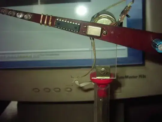

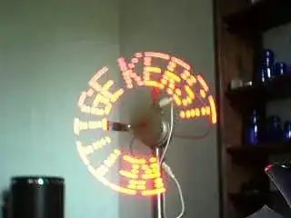

I have done this before in a commercial product:
We also did a follow on version that was larger and had 96 full color pixels vertically.
The biggest problem with not putting the control circuitry on the rotating part is the bandwidth that is then required between the rotating and fixed parts. We put the per-pixel control on the rotating board, and sent higher level (and therefore lower bandwidth) information to it from the fixed part. In both units, we used a hollow veritical shaft with a IR LED on the fixed part and a detector on the rotary part to send the information.
