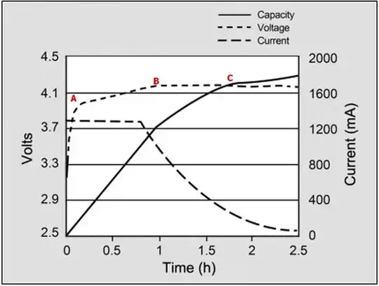

The following is probably more interesting than useful or practical but indicates that early charge termination is likely to give higher overall energy efficiency.
The diagram below from Battery University application note BU409 Charging Lithium Ion is probably quite wrong at a detail level but useful in illustrating the process. To see what is happening on the graph it is important to follow all 3 of voltage (small dashes, left hand axis, current (larger dashes, right hand axis) and capacity - solid line with no y-axis formally assigned but assume it's an 1800 mAh cell and use right hand axis (mentally) labelled as mAh. Charging is carried out at CC from start to B and at CV after B.
From start to A voltage rises rapidly and the capacity curve will be wrong (should have low slope to start) - but little capacity is involved. Importantly, from A to B capacity and voltage both rise approximately linearly. This is likely to be an area of high efficiency with loses mainly being Ichg x R internal.
CV starts at B and the inflection point in voltage and current probably should be at the same time so the graph is somewhat suspect. From B to C the capacity slope is lower and after C it's lower again. Point C is probably not a sudden sharp change as shown and (capacity increase)/watts will fall across this range. There is no easy way to plot what the actual wattage capacity increase is using normal test methods. Battery university describe the use of GMR magnetic sensors in the cells to measure SOC but short of that you'd need to conduct a number of runs and discharge the cell after a range of different charge periods and see what capacity has resulted. (More complex partial discharge methods may work).
