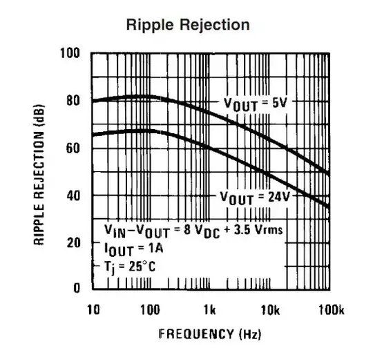

The functionally identical LM340 5V regulator from NatSemi has a slightly better specification (68 dB minimum, 80 dB typical = 2500:1 to 10,000:1) at 120 Hz.
But NatSemi kindly also provide a graph of typical performance at higher frequencies (bottom left corner of page 8).
enter image description here.
It can be seen that for 5V output ripple rejection is down to 48dB at 100 kHz (=250:1). It can also be seen that it is falling about linearly at about 12 dB per decade (60 dB at 10 kHz, 48 dB at 100 kHz) . Extrapolating this to 1 MHz gives 36 dB noise rejection at 1 Mhz (~= 60:1 noise reduction.) There is no guarantee that this extension to 1 MHz is realistic but the real result will not be letter than this and should (probably) not be much worse.
As most (but not all) smps supplies operate in the 100 kHz to 1 MHz range one can guestimate that noise rejection will be in the order of 50:1 to 250:1 in the 100-1000 kHz range for fundamental noise frequencies. However, smps will have output at other than their fundamental switching frequency, often much higher. Very thin fast rising spikes which may occur on switching edges due o leakage inductance in transformers and similar will be less attenuated than lower frequency noise.

A linear regulator has a limited bandwidth on which it can regulate. High frequencies are passed through. How good a regulator dampes frequencies is found in the ripple rejection. Look up a LM317 datasheet and search for graphs of ripple rejection ratio's against frequency:
Ripple rejection LM317
It depends on load current, input and output voltages and apparently also if you put a capacitor on the Adj pin. Moreover it drops rapidly at frequency. Most specifications are made at low frequency so it works perfectly after a transformer (which is likely to be a 100 Hz or 120 Hz ripple).
If you get a typical SMPS of these days, it may switch at several hundred kHz. Apparently a LM317 with a 10 uF capacitor on the adjust pin only manages 40 dB at 100 kHz and 20 dB at 1 MHz. A 1 MHz 1 Vpp ripple would still pass through as 0.1 Vpp ripple out. At higher frequencies it will only get worse and drop down to 0 dB, which is no amplification nor damping.
