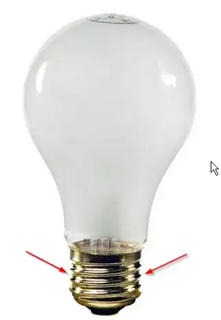

If it is wired correctly, and if a correctly wired polarized plug is used, then the threads on something like an Edison-base light bulb will be near ground potential and there is less chance of an electrical shock than if the screw is at 120VAC with respect to ground. So, it's 'safer'.

    Safety regulations have long forbidden mains-powered devices from having exposed metal connected to either power lead. The only common exception is Edison-base light sockets, which are grandfathered for compatibility. Unscrewing a light bulb will often expose the metal base before disconnecting it from (what should be) the neutral. – supercat Jul 21 '15 at 19:44
