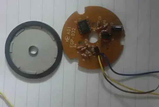

I have found this circuit mounted to a DC motor. It is probably an encoder but I don't know how it works. I have looked everywhere but I could not find a similar encoder assuming that this is in fact one. The circuit is placed on a motor casing in a way that does not allow it to rotate or move. The PCB part with green solder mask is facing away from the motor. A metallic disk with a magnetic ring on top of it is attached to the motor shaft facing the green mask and is allowed to rotate freely with the shaft. The electronic components on the PCB are caps, resistors, dual operational amplifier (IC BA728) and a regular NPN transistor (C3311). Can someone identify the type of this encoder? or better yet explain how it operates?

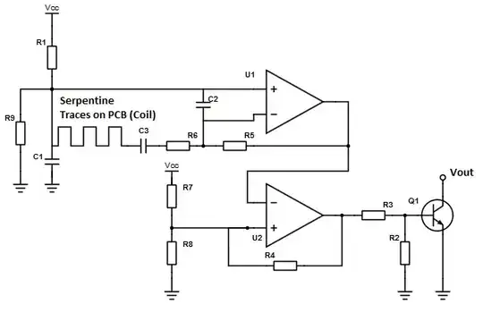

(I Modified the schematic again. Thanks, curd.)

  • It would help to see the rotating part of the motor w/shaft. If there are rotating magnets then this would be a direct drive motor. It is not a rotary encoder (there would need to be contacts on the PCB). – user3169 Jul 21 '15 at 05:05
  • Drawing the circuit diagram would help. The PCB is quite simple, it has not too many parts and is one sided so it's easy to do. – Curd Jul 21 '15 at 07:38
  • Please use images cropped down to the necessary, that makes them appear bigger within the post without having to open them externally. As others have mentioned without a schematic it is even more guess work, so help us to help you and quickly draw one. – PlasmaHH Jul 21 '15 at 09:27
  • The magnets are the grey rubber strip around the metal plate. Test them with a very small magnet, you may find it is pushed/pulled as often as the long wire zigzags. –  Jul 21 '15 at 09:45
  • Use a second small magnet (or magnetic imaging film) to determine the magnetization characteristics of the ring. – rdtsc Jul 21 '15 at 12:20
    I believe its a Tachometer, not an encoder – Scott Seidman Jul 21 '15 at 20:09
  • Can you explain how it works? – Zero Cool Jul 21 '15 at 21:31
    There is a mistake in the schematic at the + input (pin 5) of the the second OpAmp (U2). One of the three resistors at the + input is going to GND, one is going to Vcc and one (R4) is going to the output. It works as comparator with hysteresis (i.e. Schmitt-trigger; pos. feedback is via R4). – Curd Jul 22 '15 at 13:51
You'll notice that there are 8 magnets, but the "coil" (the serpentine traces) have 3-fold symmetry. This means that as the magnets rotate, the induced voltage in the pickup will vary with rotation, with a period 3 x 8 or 24 (EDIT - oops, 12, since the magnets need to alternate north and south) times the shaft rotation rate. This varying voltage is AC-coupled to the first op amp, where it is amplified and passed to the second. The second adds more gain and effectively half-wave rectifies the signal since the op amp is running single-ended. The output of the second op amp drives the base of the output transistor, so you get 24 (EDIT - 12) open-collector pulses per revolution.
Depending on the gains involved and the strength of the magnets, this will only provide reliable operation over a particular range of shaft velocities, so it is technically a shaft encoder, but unlike optical encoders it can only be used for velocity, not position, control.
It is probably used to provide precision locking of the motor to a reference speed, which cannot be done with "standard" tachometers due to voltage coefficient uncertainties and line loss, or to provide a precision rotation signal and is possibly intended for an application like use of a chopper wheel with a lock-in amplifier.

  • You have confusion. There is no alternating. Poles are irrevelant. It is just DC. Upper half of schematic is wrong. – Ayhan Jul 22 '15 at 09:09
    @luchador - Sigh. No. The magnets alternate north/south around the rim, so you DO have AC. And yes, the inputs on both op amps are switched, but I already said that. – WhatRoughBeast Jul 22 '15 at 13:34
  • I don't think so. If the magnets were like you said, than the total potential induced would be zero. The zigzag is one piece covering whole circle. – Ayhan Jul 22 '15 at 13:40
    @luchador - That would be true if it were not for the 3 interruptions in the pattern. They are important. – WhatRoughBeast Jul 22 '15 at 13:41
    I haven't noticed the 8 alternating magnets. Now it makes sense! – Curd Jul 22 '15 at 14:10
    BTW: the 2nd OpAmp works as Schmitt-trigger. The schematic is wrong about the three resistors at the positive input. Actually two of the form a voltage divider between Vcc and GND. One of them comes back from the output to give positive feedback for hysteresis. – Curd Jul 22 '15 at 14:15
    @Curd - Ooh. Good catch. I'd wondered about the two resistors in parallel. And it does increase the dynamic range wrt shaft speed by making the pulse transitions more stable than they would be if the op amp were just using asymmetric swings. – WhatRoughBeast Jul 22 '15 at 14:48
  • @WhatRoughBeast Thanks for all your efforts really. I don't mean to be rude but I checked and traced out the circuit so many times. And if there is one thing I'm sure of, it is the connections to the input terminals of the first op-amp especially after u mentioned that to me. They are not swapped. – Zero Cool Jul 22 '15 at 18:54
    Well, then I got confused. My apologies. I've edited my answer. – WhatRoughBeast Jul 22 '15 at 19:56
The zig-zag is designed to intersect the magnetic field of that magnet. It must have not been constructed as a series of opposite poles horizontally, it must be of same poles vertically. In that way it will expose the magnetic field which the zigzag can intersect most perpendicularly. The change of the rotation angle will induce a potential on the zigzag. So, the output of the circuit is proportional to the angular speed. Sorry for my bad language.
