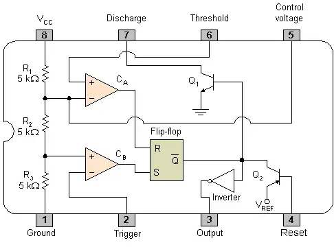

Here is a simplified view of interior circuit of the 555:
Note the three 5K resistors on the left that create a voltage divider; that's where the name 555 comes from. The resistors set up a voltage of 2/3 V on the - input to the upper comparator C\$_{A}\$, and 1/3 V on the + input of the lower comparator C\$_{B}\$.
When the TRIGGER falls below 1/3 V, the lower comparator C\$_{B}\$ outputs a high and sets the flipflop, and the OUTPUT goes high. The external capacitor C1 also starts to charge. When the external RC network made up of R1 and C1 reaches 2/3 V, the upper comparator C\$_{A}\$ goes high, and resets the flip-flop, and the OUTPUT goes back to 0.
Potential problem: Looking at the interior circuit of the 555, if the TRIGGER input is held low for longer than pulse length, it will keep the lower comparator C\$_{B}\$ high and the OUTPUT will remain high.
You can get around this problem using a differentiating input:
It generates a short negative going pulse regardless of how long you hold the switch down.

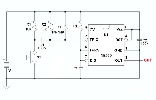

One thing that hasn't been mentioned yet is that the input trigger pulse must be shorter than the output pulse, otherwise the output will just follow the input.
Also, you can run everything from Vcc, as shown below with the TRIGGER input cap-coupled to the switch, ensuring that the input pulse will be short, no matter how long the button's held ON.
RtCt are the timing components, and the output pulse's ON time will be 1.1RtCt.
The diode in the triggering circuit is used to clamp the 555's TRIGGER pin to Vcc plus one diode drop when the switch is released and the coupling cap is acting like a charge pump.
If you use a bipolar (instead of CMOS) 555 you'll need to decouple the chip from the supply wiring with a cap directly across pins 1 and 8 in order to provide a local reservoir for the totem pole's ~ 400mA supply current transient during an output transition and, finally, here's a link to an LTspice schematic you can use to run a simulation if you want to play with the circuit.

  • tried constructing the circuit you gave today, no luck. gives a constant ~2.5V with V1=6V. are the open circles on pins 2,4,7 of the 555 representing anything? theyre not "NOT" gates are they? – Jordan Cartwright Jul 21 '15 at 16:13
  • @JordanCartwright: The circles mean that those signals are "active low". That is, if you want to trigger the timer you pull pin 2 low, if you want to reset the timer you pull pin 4 low, and when it's time to discharge Ct the chip will pull pin 7 low. Other than a wiring error or a bad chip, I can't imagine why it's not working. In particular, take a look at pin 2 and make sure it's not connected to any other pins. – EM Fields Jul 22 '15 at 09:55
  • @JordanCartwright: I just edited my answer to include a link to an LTspice schematic. – EM Fields Jul 22 '15 at 15:44
  • it was a wiring error sorry! i didnt notice that the pins were arranged differently on the diagram compared to the datasheet (rookie mistake!) It's working great now, thankyou for your help – Jordan Cartwright Jul 23 '15 at 06:44
