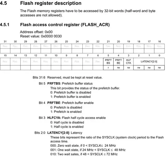

When I use GDB to debug, I can see the FLASH_ACR register has the contents of 0b0011 0000 which signify that the prefetch buffer is both enabled and has a status of enabled, with 0 wait states for flash. Plus, the prefetch buffer should be enabled on reset as per the datasheet. When I write to the register by or'ing it with 0b001 I get the expected result of 0b0011 0001 back after reading from it again. This is done doing the following:
// Change the flash wait states to 1.
volatile uint32_t foo1 = FLASH_ACR;
FLASH_ACR = FLASH_ACR | (0b001 << 0);
volatile uint32_t foo2 = FLASH_ACR;
Interestingly enough, enabling or disabling the prefetch buffer with a 1 wait state makes no difference in my loop, which doesn't seem to make sense.
And here is the relevant section of the datasheetFlash ACR
I am using an NUCLEO-F303RE board, which uses an STM32F103RE.

    The [datasheet](http://www.st.com/web/catalog/mmc/FM141/SC1169/SS1031/LN1565/PF164485) is not very helpful. My guess would be that the flash bus clock is *delayed by 1 Tcy* for FLASH_ACR = 0x01, and *delayed by 2* for 0x02, *regardless* of prefetch. Did you try 0x02 to see if it degrades another 66%? – rdtsc Jul 21 '15 at 22:01
  • I thought I saved the data related to when I change the wait state to 2 nut it seems I didn't. From what I remember, it was 1.2 to 1.5 seconds. I will recheck when I get home. – hak8or Jul 22 '15 at 23:32
The cache buffer in STM32F303RE is only 8 bytes (64 bits) therefore if your cycle code is longer than 8 bytes it will have no effect because the buffer is rewritten each cycle again and again. Here, the I-cache could help you but as i see there is no I-cache in this MCU.
It is preferable to use a timer sourced from an always constant clock, like 32.768 kHz or other oscillation, to count delays. Your MCU implements many timers and the RTC, try to use one.
