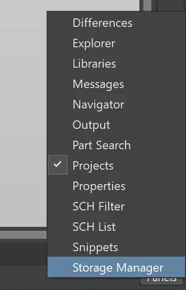

Files such as schematic sheets can be renamed from within Altium using the Storage Manager window. The method for accessing the Storage Manager was changed in Altium 18.
To access the Storage Manager click on the Panels button on the bottom right of Altium.
Then click on Storage Manager
Inside of the Storage Manager you can right click your file under the Project Files heading and select rename (or hit F2).
