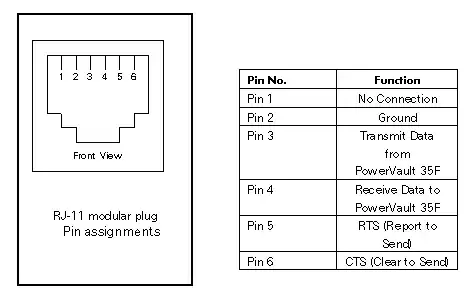

Examples - these are useful mainly to show how thoroughly non standard the various arrangements are.
Dell RJ11 - one implementation
H2Ns page describing their RJ11 serial pinout and connections for interfacing to other equipment
H2NS's contribution to the fun.
Here's an interesting page from Unitronics they have a number of somewhat different "arrangements"
Here's a plug pinout from one of their several arrangements - it's notable for being different from but similar to the Dell arrangement above. TXD and RXD are the same and there's some other partial similarities.
