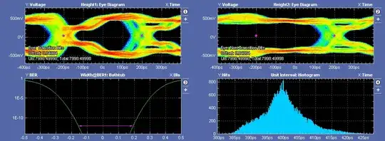

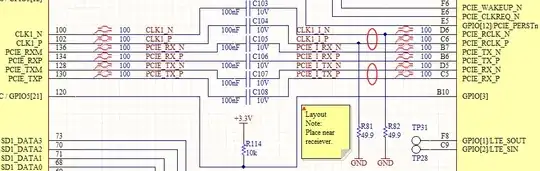

I've done some signal integrity measurements by soldering a high speed scope with proper differential probles right on the other side of the inline caps shown below:
For the clock the eye diagram looks quite good:
But the TX data not so much:
The WiFi chip has on-chip terminations so I don't believe I am supposed to need any additional terminations, but I could be wrong about that.

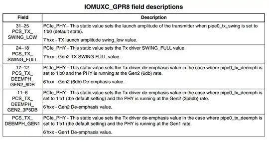

I have found some registers that can be set within the i.MX6 processor for the PCIe peripheral but I'm not exactly sure what they actually do. A little bit of trial and error hasn't gotten me very far either.
I've checked that the layout follows proper routing rules and the PCB was constructed with the correct impedance. Obviously I have some jitter in the system but it also looks like I have a reflection or de-emphasis issue. I'm hoping someone could describe what they see wrong with my eye diagram and/or suggest some ways to fix it.

  • @akohlsmith & SomeHardwareGuy The values are about mid-range right now and based off their dev board. I believe only two of the 5 registers actually have an impact at any given time. It seems the FULL_SWING register is in effect while the LOW_SWING is not... haven't nailed down which de-emphasis one is active but I'm working with Freescale support to understand what pipe0_tx_swing and pipe0_tx_deemph values are since they are nowhere else in the documentation. I'll report back if I find out more on this. – Funkyeah Jul 14 '15 at 07:09

The de-emphasis field above helps you get a clean eye at the receiver by bringing the non-switching amplitude down relative to the nominal launch amplitude.
If you are losing too much amplitude at the switching edge of the signal, set this field to a larger value. You might also set the nominal launch amplitude a bit higher as well.

Where, relative to the transmitter, are the coupling capacitors? They should be as close to the transmit pins as possible. Once they are more than half a wavelength of 10GHz (about 0.6 inches on FR4) [double that distance for 2.5Gb/sec links], they will most definitely reflect energy.
I have had problems with capacitor geometries of 0402 or larger in PCI express gen. 2 and I now use reverse geometry devices (0204) for the reduced effective series inductance. These seem to be getting the job done very well.
Looking closely at the eye diagram for transition bits (nice scope you have, by the way - that is what you need for this stuff), the initial signal drive appears to be driving a terminated line (the signal goes to 0.5 V(nominal) in the classic transmission line manner). This is not a particularly long line (the round trip time is where the signal drives to full V[nominal]).
you say that the link is running at 2.5Gb/sec (gen 1) and that is what the scope traces show, but you may want to experiment with the de-emphasis field (look in the reference manual as well as the electrical data sheet (see note below). The 'standard' de-emphasis values are for a nominal link, not an embedded link such as you have here (and what I also do regularly). If you can get it to about 6dB, you may get better results.
The nominal de-emphasis is 3.5dB for Gen 1 and 6dB for Gen2. I note that the field above seems to imply that a Gen 2 link is 3.5dB - you may want to dig a bit on that. The link you have needs a minimum of 3.5dB of de-emphasis.

Up to the 2.5Gb/sec node, 0402 devices are fine. My handy calculator shows a typical 0402 device has about 10 ohms of impedance (inductive) at this frequency and 21 ohms at 5GHz (the highest frequency of interest). This is not too bad in a 100 ohm differential system as the effective impedance of a closely coupled pair is somewhat less than a straight addition.
The self resonance for this device is 19MHz, well below all frequencies of interest, so any phase noise is due to ESL. Keeping the impedance down to less than about 1/3 of the effective track impedance means that the phase noise (and therefore additional ISI) we will get is between 1 and 17 degrees (a single ended track from a closely coupled pair is typically (Z(diff)/2)*1.25, so for 100 diff, the single ended impedance is about 65 ohm). This amount of phase noise is manageable.
At 10GHz, the effective impedance is about 44 ohms, and can start to interfere with the differential pair by introducing excessive phase noise across the frequency band of interest as the maximum phase is now about 34 degrees. Although I have successfully done Gen 2 with 0402 devices, I have also had issues with longer runs and now use 0204 reverse geometry devices for this speed and higher.

So your plot above shows classic transmission line behaviour with little excursions beyond the expected behaviour. In fact, this is one of the cleanest transmitter eyes I have seen.
