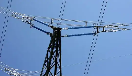

Corona rings can be seen at either end of the insulators in the photo below.

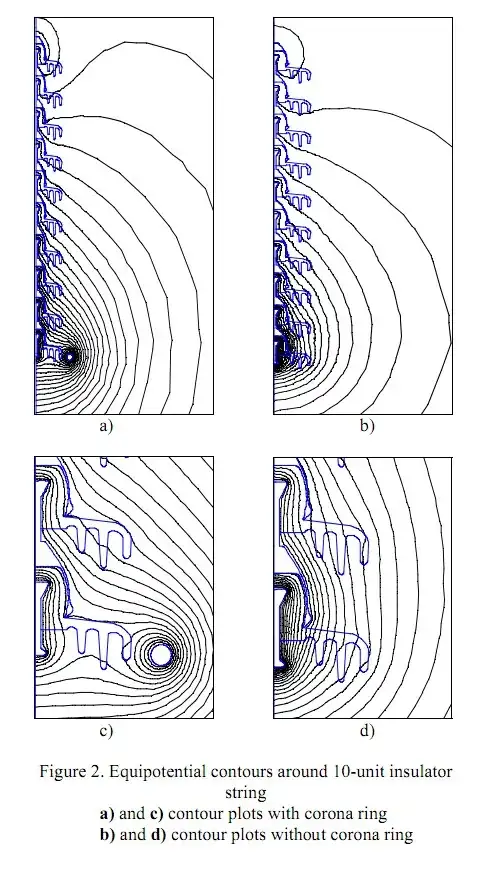

Illustration of electric field distributions with and without corona ring on multi insulator string. See the "superb reference" paper above for discussion.
