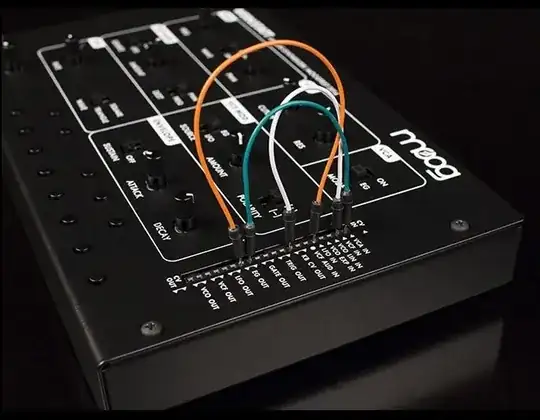

One of the comments has already mentioned a Moog synthesizer costing $35,000. However Moog also sells many other synthesizer models in various price ranges, at the bottom end is a kit for $329 called the Werkstatt-01 which is shown below. But you don't have to buy one; you can download the schematic from their website, and use bits and pieces of their design. Combined with the document referenced earlier, you should have plenty of ideas.
