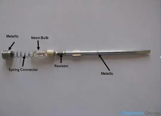

TYPICAL "NEON TESTER":
Tested voltage is contacted with blade tip.
Finger is placed on metallic top cap.
Circuit is Voltage_in - tip_resistor - neon - YOU.
Neon lights if voltage present.
