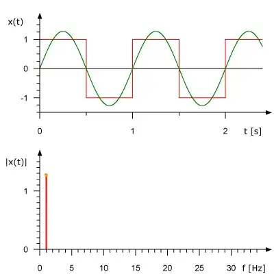

The bandwidth is the range of frequency beyond which a sinusoid is considered to be attenuated (conventionally, by -3dB or a factor of \$1/\sqrt{2}\$).
However, digital signals are not sinusoids. The Fourier transform shows that any digital signal (any signal for that matter) is made of a defined superposition of sinusoids, with defined amplitude=f(frequency) characteristics. At least instantaneously, because Fourier transforms strictly speaking apply only to periodic signals (i.e. clocks, not comms signals).
The very sharp edges of digital signals require high frequency sinusoids to exist; as they are low-pass-filtered, the corners will degrade into ringing, reducing the plateau representative of the binary value.
Meaning: for a digital signal of X Hz, you need the medium to have a bandwidth much greater than X Hz, "much greater" meaning at the point where the distortions at the corners of the signal are negligible for your application.
In your case, distortion means a lower quality signal, therefore either an increased error bit rate for the same datarate, or a decreased datarate for the same error bit rate. This phenomena is more important for QAM64 than it is for QAM16 for example because the levels to resolve are much smaller.
That's certainly what Lorenzo Donati meant by "bandwidth proportional to baudrate". Again, this depends on the requirements, but a gross guesstimate could be bandwidth >= 100*baudrate.
Edit: Here is an illustration of how the digital signals are constructed from sine waves. Imagine applying a low pass filter to these sine waves, and your will understand why the bandwidth cannot be simply equal to the baudrate.
