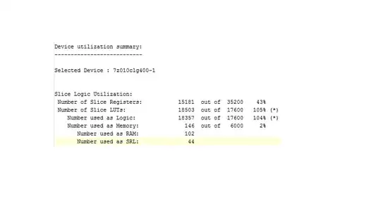

Below is the device utilization summary for the design(Zynq 7010) and the use of Slice LUTs exceeds the availabile number. Previously it was 82% and now it exceeds after adding a block of checksum code 4 times. Is there any tweek to merge LUTs and reduce its consumption or need to make manual optimization in the code?
Device Utilization Summarry

  • Based on your data, your CRC checker module would take around 880 slice LUTs, which is enormous IMHO. I find the hierarchical netlist view in Vivado very helpful to identify the largest blocks in your design, blocks you should focus on making smaller. Playing with synthesis option will only get you so far. Beside, it is not unexpected to see a 90% utilization design fail routing, I always target 80% at most. – Jonathan Drolet Jul 01 '15 at 15:26
  • The crc checker module is a small piece of code. I do not know why it takes that much resource or is there something else in the design which is causing this issue. I need to find it first. Is there any way to know the hierarchial netlist view in PlanAhead(14.3)? – Pradeep S Jul 01 '15 at 15:53
    Open the synthesized (or implemented) design and press "F6". Any reason not to use Vivado? If you trust Xilinx (and you can on that matter) it will yield much better design for the series-7. – Jonathan Drolet Jul 01 '15 at 15:58
  • At my work, need to use it. So I have to get some info which can be used for older versions. – Pradeep S Jul 01 '15 at 16:07
  • Qucik question, why you don't have any number in your BUFG section? Put -1 to use maximum number of BUFG or specify a number there. And do you use XST as your synthesis? Vivado is much more suitable for Zynq family. – FarhadA Jul 02 '15 at 07:42
Remove the register duplication, it increases the speed of your design and have very negative impact on the utilization of LUTs in your design.
Those are mainly for the designs that have high fanout and needs to duplicate some of the resources in order to meet the timing.
Also, look into your code and see if you can remove the reset from some of your logic, specially parts that can be packed into SLR or RAM, that is one of the common mistakes people make, removing the reset, will help Vivado to pack some of your logic into BRAM or SLR and you will see a significant decrease in the number of LUTs used.
If none of those works, maybe your design is just too big for the FPGA you are using!
