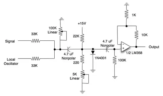

Diode mixer
About the simplest and cheapest mixer available is a "diode mixer" which uses the non linear characteristics of a diode to mix two signals. There are simpler versions than this enter image description here
but this is a bit more explanatory visually than the simplest possibilities. Circuit diagram from here
See here for a few dozen more diode mixer circuits - that's just a Google images search on diode mixer.
