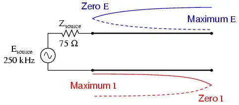

A quarter wave unterminated cable will look like a short ciruit and this is to be avoided for obvious reasons. As the cable reduces in length things get better for the high frequency parts of your signal spectrum and, generally by about one-tenth of a wavelength terminations are forgotten about.
Here's what an open ended line looks like when its length is matched to a quarter wavelength of the applied voltage: -
(source: ibiblio.org)
And, if you really want to understand more about it, this site can help
