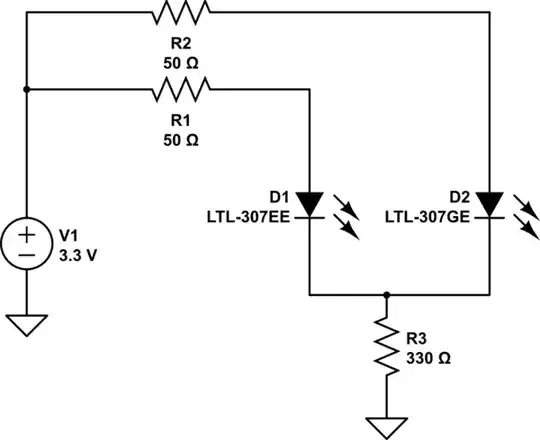

Here's a simulation assuming the output pins of the micro look like 50 ohm resistors.
The currents are not all that bad. 2.8mA for the RED and 1.7mA for the GREEN.
If you assume the outputs look like 0.1 ohm resistors, the currents go to 3.4mA and 1.5mA.

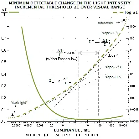

It should be noted that this is highly dependent on the type of LEDs and similar types made with different technology may not work as well. As well, the current in (say) the GREEN LED will change greatly when the RED one is illuminated. Although your eye responds logarithmically so the absolute brightness won't look radically different, the change will be very visible.
