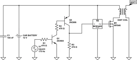

Here is the schematic (C1 is the decoupling cap for the MCP1402 and is physically located close to the MCP1402):
The purpose of the transistors at the beginning is to prevent the negative voltages coming out of our function generator (it's hard to configure and easy to screw up) from reaching the MCP1402. Our fall times being sent into the MCP1402 are quite long (1-2uS) due to this crude arrangement, but there seems to be an internal hysteresis or something preventing this from causing problems. If there isn't and I'm actually destroying the driver, let me know. The datasheet doesn't have any input rise/fall time parameters.

The problem that has just been plaguing this design has been a combination of ringing on the gate line and slow switch times. We've destroyed more MOSFETs and totem pole BJTs than I care to remember.
The MCP1402 seemed to have fixed some of the issues: no ringing, fast fall times; it looked perfect. Here is the gate line without the ignition coil attached (measured on the bottom of the gate pin of the MOSFET, where the green&white wire is plugged in above):

  1. What in the world destroyed the driver? My thought is that the large gate transients found their way back into the gate and somehow exceeded the maximum reverse-current of 500mA.
  2. How can I suppress this ringing and keep it clean when driving the inductive load? My gate length is about 5cm. I have a selection of ferrites that I could use, but I honestly don't want to blow up another gate driver until someone can explain to me why this happened. Why doesn't it occur until I connect a highly inductive load to it?
  3. There is no reverse diode over the ignition coil primary. This was a conscious decision to avoid capping our voltage spikes, but could be misinformed. Would capping the primary voltage spike with the diode cap the secondary voltage spike at all? If not, I would gladly put one over it to avoid needing the more expensive 1200V MOSFETs. We have measured the drain-to-source voltage peaking at about 350V (~100nS resolution), but that was with a slower gate driver, so there was less di/dt.
  4. We have a selection of 1200V IGBTs that could be used (they're just sitting here on my desk). Would these have as much trouble as the MOSFETs driving this sort of load? Fairchild seems to suggest using these.

  • I would wager it's collapsing magnetic field from the ignition coil when you shut the fet off, as you said you made a conscious decision not to put in any protection – Some Hardware Guy Jun 29 '15 at 18:06
    Very well-written question. I wish most people gave at least 10% of the effort that you did! However, I expect it will soon be closed as a duplicate. You have the solution in your 3rd question. You need that diode for this very reason. – bitsmack Jun 29 '15 at 18:08

  • Wouldn't a simple current-limiting resistor remove the need for your complicated input circuitry to the gate driver? – Nick Johnson Jun 29 '15 at 18:32

  • I think that placing a TVS diode between gate and ground on the MOSFET will prevent damage to driver because the voltage spike in the primary will couple to the driver output due to the parasitic capacitance from gate to drain. As you can see in the IGBT from your app note they have the same protection from gate to source. – Kvegaoro Jun 29 '15 at 19:02

    I think you are confusing the operation of a transformer with an inductor. You need to put a TVS diode across the primary that clamps the voltage to a safe level. The max output you'll be able to get on the secondary will then be limited by the TVS clamp voltage x turns ratio of the two coils. If this is not enough only then will you need to move to a higher voltage MOSFET. – Jon Jun 29 '15 at 19:35
    Also if you just use a flyback diode it will clamp both the primary and secondary voltages to almost zero as you suspected. That is why you need something with a higher clamping voltage. It might be useful to read about flyback converters as this is what your circuit is. – Jon Jun 29 '15 at 19:39

Holy Carp! You're trying to do 10's of nsec switching on a solderless breadboard? And you don't have a flyback diode on your transformer?
If you're going to do this stuff, you've got to learn to respect fast switching and inductive parasitics. Go to a ground plane and make all your switching paths as short as possible. Also, put a 100 uF cap (tantalum for choice) across your MCP1402 to give the flyback diode something to drive besides the long leads to the battery.
You see those regular bumps on your no-load waveform? They are ~40 MHz oscillations and they are not a good sign.

A combination of the IRF840's reverse transfer capacitance (120pF), the dv/dt of the drain voltage and the rather weak driver (MCP1402) is my best guess.
Starters, read the data sheet on the driver - it says on page 3 that the "latch-up protection withstand reverse current" is typically greater than 0.5 amps - that is a clue to why that device might be failing.
Next is Q = CV or, dq/dt = I = C dv/dt.
I'm thinking that the current through the 120pF with a big change in dv/dt on the drain is more than the driver can cope with. Just before the scope picture goes all bad I see something like 10V change in about 20ns therefore:
I = 120pF x 10V / 20ns - that is 60mA but that's just the voltage seen on the gate - it might by ten or a hundred times bigger on the drain and therefore the current might be 600mA to 6A forcing its way thru the reverse parasitic capacitor into the driver chip.
This is my suspicion anyway. I'd use a driver capable of ten amps or at least find one that can cope with a reverse current of ten amps.

Andy's on to something, I believe, with the drain-gate capacitance.
But also: Measure what this is doing to the 12V supply. That would be an alternative path for spikes through the gate driver. Currently you're showing a single 0.1uF capacitor as decoupling, and I suspect that isn't enough. You may need a broad spectrum of decoupling from 10nF up to 100 uF or more, and if that isn't enough, consider powering the gate driver and sensitive electronics from an L-C filter and their own local decoupling.
Just place 220..470nF MKP capacitor parallel to the transformer to damp high peak voltage produced by induction coil. Now interrupted current will go to capacitor instead destroying FET.

Your Gate driver is being destroyed because of voltage spikes when MOSFET turns off..
Check this out: Snubbers
