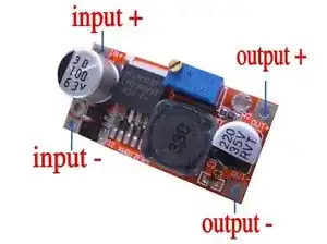

Use a buck regulator is realistically the sane choice. Maybe one of these: -
They appear to cost about £7 from ebay here.
But, as always read the small print and check out a few others. I just googled "15V 3A buck regulator" and this was the first hit and I think it may be a little underpowered so go for something a tad beefier.

1One I looked at was sold as "12A"- it had a 12A fuse and a chip with 8A (datasheet) capability.
– Spehro Pefhany Jun 29 '15 at 18:06
